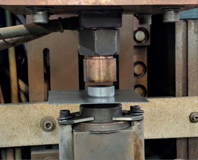

On my resistance welder, the top and bottom electrodes are not aligned. They are parallel, but centerlines are off by about 3/8". The top electrode presses down with 9000 lbs. psi. Given the heavy force load, and the fact that the projection (ring) around the bottom edge of the welded piece collapses as it gets heated and welded... might this weld crookedly, because of more pressure in one side? Or is the pressure equally distributed in the welded piece (the adapter), despite the misalignment of the two electrodes (as shown ind drawing)?
I feel like I'm thinking too hard on this one, and confusing myself.

I'm not an expert, but I'm thinking that if the upper electrode and lower electrode faces are parallel that the loading on the adapter should be uniform. If you hold something in a vice, it doesn't have to be in the center of the vice if the vice faces are parallel.

True 'nuff. But a vice doesn't apply 9000 psi. So.....
I still can't really be sure by using that logic.

" it doesn't have to be in the center of the vice if the vice faces are parallel"...... but, if there is play in the vice slide, the jaws will tilt & grip harder on one side.

Yes, that's my thought, as well. I can't tell if there is play... but there may be. And if the mis-alignment was corrected in both x and y, that possibly would be eliminated or at least greatly reduced.

Depends on if there is any give in the assembly...how rigid is the upper and lower electrode assembly? will there be any give at 9000 psi force? It is aesthetically disturbing, but that might have no significance here...The other thing to consider is the electrical field characteristics, is this causing uneven amperage discharge? ...this should be apparent in the weld characteristics and uniformity...

AS I replied to lyn... Not sure how the rigidity of the welder applies to this particular weld at 9000 psi. 9000 psi is on the high side for this welder. Also, as I said below... this welder is a mess that I'm untangling one issue at a time. Currently, it's the misalignment.
As far as the electrical field... yes, that could also be an issue. But there are many issues going on at once in combination, so it's difficult to blame any one alone for the various inconsistencies. At least until I go through the list and eliminate or address a bunch of them.
I don't know enough about the what you mentioned regarding electrical field. Could you elaborate in dummy language. Electrical is not my field.
And yes, it is visually disturbing.

If the electrode and the base are RIGIDLY mounted and parallel and able to resist any flex when the 9,000 pounds of force is applied, it's not a big deal. (I don't think it's 9,000 PSI unless the total contact area of the two surfaces being welded = 1 sq. in.) It's probably more at the weld.
There is the issue of unequal thermal transfer into the workpiece if the electrode is offset. Probably not that important in this application.
If the joint isn't failing and the adapter is still parallel after welding, I'd fix it when it's time for PM. (or just ignore it)

This is at least my 2nd or 3rd question related to this particular resistance welder, whose trouble-shooting appears to have become a career. It never had a lick of PM over more than a decade. Our welds are not consistent quality welds. I'm trying to root out the problems one by one. They are undoubtedly caused by many separate things. There are so many, it's like doing an experiment with a dozen variables. So, this is where I'm at now. The misalignment. The way the weld is designed at the contact point makes it particularly susceptible to an uneven loading, if in fact an uneven load exists. Actually, I didn't draw it correctly, as there is an additional inner ring, along the ID of the adapter, that fits down into the hole in the sheet metal. It is supposed to be flush with the inside surface of the sheet metal after the welding. I'm getting inconsistency in that regard. The problem is... there are other things it could be, as well. So I'm trying to eliminate this issue if possible. I don't know how rigid the set-up is. I mean... it's a resistance welder, as shown in photo. I don't know how the 9000 psi relates to a resistance welder's rigidity.
After this, I have to try to figure out why there has been a "force creep" over the last 7 years. The set-up started with a force setting of 6000 psi. Over the years, they have had to incrementally increase the force in order to get the same weld result. Now it's 9000. Clearly the actual cause for the creep is elsewhere, and upping the force is the way they dealt with it... but I don't believe it was the proper way because they never figured out why it was happening in the first place. They dealt with symptoms rather than the cause.
But... that's another story. I'll gt to that after I either eliminate or confirm this misalignment as being cause for inconsistent welds. Far too many scrap pieces.

I don't know how much actual force you have. 9000 psi is pressure, you have to multiply by the area in contact to get the force.
If the faces of the upper and lower electrodes are not exactly parallel, you would have more current and more pressure on the side where they are closer. More current on one side could also be due to the condition of the upper or lower electrode.

Let's address the flushness problem. If you mark 20 pieces, tank and adapter on each side and place them in the welder is the defect consistent. Can you identify the defect relative to the electrode offset?
What happens if you go back to 6K pounds of force?
Do you have any way to measure the force exerted on both sides of the electrode to see if it is even when seated?

Clearly the misalignment can't be good! So why haven't you corrected the misalignment? If the welder has had no PM for a decade, it's probable that some part has gradually shifted. There are three ways I can think of for shifting: bending, wear, or slipping. Since you say the electrodes are parallel, then it's not likely bending.
One of the electrodes is normally fixed, and the other one (usually the upper one) moves. That motion requires either a linear slide of some form or an arm rotating about an axis. Either the slide or the axis can wear, but 3/8 of an inch is a lot of wear. Check the moving parts for wear!
Somewhere, there are bolts that mount the electrode assemblies to the machine base. Some of those bolts may pass through slots or oversize holes, to permit correct alignment. If so, loosen, align, then retighten.
Of course one of the electrodes must be insulated from the machine base. Many insulating materials degrade over time; perhaps an insulator has worn or decomposed. Check them out!
Get the alignment corrected, then you can start thinking about other things. As Richter indicated, you said "9000 lbs. psi". It could be 9000 lbs of force, or 9000 psi pressure, but it can't be both, unless the contact area happens to be 1.0 square inch. 9000 psi is a fairly dangerous pressure, so I suspect you really mean 9000 lbs of force. Either way, that sounds high!

Thank you. But I'm not asking how to fix the misalignment. I'm asking if the misalignment is causing more force on one side than the other. It isn't an easy fix, for reasons too many to list here. What I'm battling here is other people's opinions at my job that don't believe it matters, claiming it's the same force anywhere on the electrode, as long as they are parallel. I came here to find reasoning that I can use to explain it to them and justify ordering the fix to be made.

Perhaps it will be easier to argue that the offset is creating a torque on the workpiece originating at the place being welded.
If people are not understanding the problem, you might ask if they think there would be a problem if the misalignment was 6"?...5"? ...4"?...

You are correct. They are not understanding. They feel that the torque is not sufficient because the machine is rigid.
That may or may not be true. But the best way of dealing with that would be to eliminate the possibility, by making the alignment. Convincing them of that is difficult, because to accomplish the alignment is somewhat complex and it will also put the machine down for unspecified amount of time. My reasoning needs to be stronger than their concerns. Yes, I think I will use your suggestion of asking them at which point they think that there is actual torque. They won't know that answer, of course... so yes, I may use that as part of my logic to them.

By the way... I believe that the reason for the aforementioned shifting is that the linear actuators are failing or have shifted themselves. The welder has three positions. These three positions are attained by two actuators in line... end to end. For the first position, both actuators are un-extended, and the first lower electrode is under the upper electrode. For the second position, one actuator extends, moving the middle electrode into place. And for the third, far right electrode, the second actuator also extends.
This should have been obvious to our maintenance guys. And they should have fixed it long ago. But as I said, they didn't think the misalignment (in this case, the x axis) mattered.
In any case... if you read my last reply to lyn, you'll see that I've managed to get the manufacturer to agree to come in and fix every single thing and make the whole welder as close to like-new, as possible! Our crappy maintenance contractors won't have to lift a finger. Not that they would, anyway.
It'll cost us a bit to have this kind of complete overhaul (stuff we should have done ourselves through regular PM)... but it will be well worth it to finally have this poor welder attended to. I believe it will be an offer we can't refuse.
After that, all I'll have to do is to enforce a strict daily, weekly, monthly PM Schedule. Easier said than done, but I think management here will help me with that enforcement, as they know they have egg on their face by being manipulated by our maintenance guys for so long, and letting it get to this stage.
