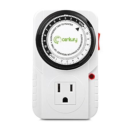

Hi all,
A little backstory. Earlier this year I bought a bearded dragon. I was told they need typically 12 hours of light, and 12 hours of darkness, to maintain a healthy sleeping pattern. I am going to design a circuit with a microprocessor that switches a relay every 12 hours because there are some days where the light is on for up to 16 hours. So I am going to automate the process a bit. I was thinking about using 2 SPDT relays, one for the heat lamp, one for the UV lamp. Question is, am all I looking for is a SPDT relay with a 5VDC input for switching and a 120VAC output? The heat lamp is 60W and the UV lamp is 45W. Any recommendation for 2 good relays that I could use?

There are timers used to control lights when on vacation that would probably do what you want...
https://www.amazon.com/electrical-timers/b?node=495340

Why dual throw?
Why not: single pole, single throw, NO (1 FORM A)
(You could go for dual pole if you want to switch live and neutral.)
Go to Digikey or mouser and search for relay then filter your results 'til you get what you want:
SPST-NO
SPDT
$2 or $40 (doing dual throw with a mechanical switch is easy: you just have a central rest position, but, with a relay it gets a lot more complicated).

Oh I actually meant DPST sorry. Throw connected in parallel, one pole for the hot leg of the heat lamp and one pole for the hot leg of the UV lamp.
Re: Timed Light Switch
02/15/2019 6:14 PM
Why DPST. Why not tie both the UV lamp and heat lamp to the load side of an SPST switch?

You may find it difficult to find a (5V) TTL level relay coil with enough mechanical force to close a 10-15A relay armature. There is also the back-EMF to consider as the coil is deenergized, a reverse polarity diode across the coil to protect your computer output. The drive capability of your computer output may require you have two relays, one small enough to not overload your computer output, to drive one heavy enough to switch your power circuit.
If you gang a day timer, it measures the passing of each day, with 12 hour stoppers, and wire a photocell to extend the daylight, if it gets dark before 12 hour light cycle expires. Run the timer continuously for consecutive 12 hour cycles. Turning the lights on at dusk and run them until the 12 hour stopper comes by, would that do it?
Cloudy day, the lights would run 12 hours at a time, one stopper turns them on, the other stopper turns them off. If there is plenty of light, no lamps needed, just like in the prehistoric times...

If its a 45W and 60W bulb, theres not a lot of current going thru this. The 60W itelf doesnt even go above 1 amp. I already have a flyback diode for back emf in my schematic I drew up earlier. Your last 2 paragraphs made no sense to me.

If you are capable of designing the circuit I would think you are capable of picking a good relay?
It seems very redundant but why not attach a relay to a vacation timer and use it like a contactor switch. Bam circuit designed.

do a search for something like an Arduino and a plug in shield (board) with relays or if you are designing your own use a driver transistor to fire the larger relays...

I’m not a big fan of the arduino. It takes away the beauty of having to design the pcb from scratch and figuring out the correct components. And yeah good idea, I’ll probably end up using some MOSFET for the switching.
