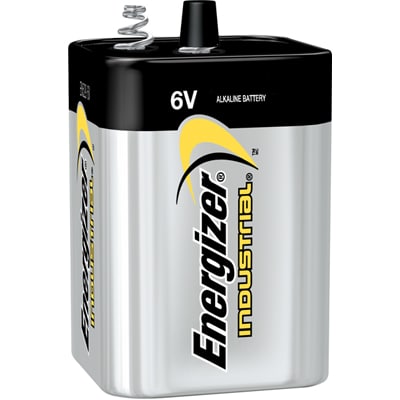

Posts: 33401
Re: Battery Consumption Calculation
03/18/2019 12:02 PM
Why wouldn't you just go with 6 volt lantern batteries...?
03/18/2019 12:42 PM
Connectors, cost, lack of thermal trip.
