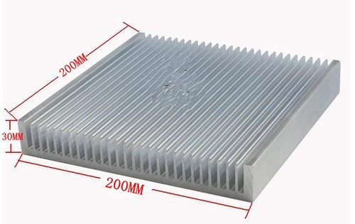

appreciate the link, handy for the future, as present i am strictly concerned about the stability of a heat sink disk i am working with, doesn't need to reflect just conduct the heat away from my 10x10 100 watt led chip array, without warping at the slightest bump. any suggestions? measurement is: 9.5 " in diameter by 0,80 thick.

I wouldn't think an 0.8 inch thick x 9.5 dia aluminum disk would warp. Aluminum is a good conductor of heat, so both sides would not differ that much in temperature.
Heat has to go somewhere, so for continuous use, heat sinks are usually finned to expose maximum area to convecting air. If your use is not continuous, a large block can absorb the heat for a short time.

Volume = π×4.752×.8 = 56.705747397296 inches3
This doesn't sound right....surely this plate must be ribbed...

To design a heat sink you need to know how much heat is being generated, and determine the ambient operating temperature range...You must also take into account the free airflow available in the design of the fixture...So you need the efficiency of the LED's, the total wattage, contact area available, technical drawing of the light fixture...
