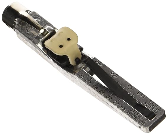

I've experienced slipping V-belts but this is different. That makes me lean toward the idler since I've never had/heard one fail.
The belt seems tight but I can't get my click-it on a suitable section of belt to check.
    Gates 91107 Belt Tension Tester
    Great little tool, by the way,
Re: Screeching From Under The Hood
05/01/2019 2:24 AM
Umm, an idler pulley does not create belt tension.
An idler pulley serves as a device to guide the belt.
A tensioner removes the belt slack.
You can put your fancy tool on the belt all day and it won't tell you that the idler is bad.
The only way to tell if it is bad is to remove any tension from it.
