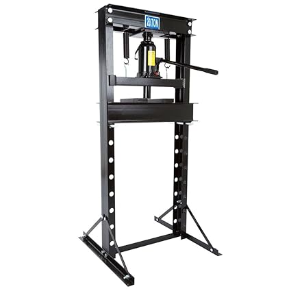

Previous in Forum: Mechanical Linkage   Next in Forum: Gasket Compression Calculation for a Known Load
22 comments
Join Date: Feb 2019
Posts: 19
Help With a Calculation
09/02/2019 9:01 PM
Trying to calculate the force required to deform a cross section of a solid cylinder. To create an image, imagine a cylinder laying on a flat surface, and then a section of it defined as a length of X, being subjected to a compressive load. I'm trying to find the correct formula for this. Any help is greatly appreciated.
Posts: 9938
Re: Help with a calculation
09/02/2019 9:42 PM
Join Date: Feb 2019
Posts: 19
Re: Help with a calculation
09/03/2019 8:05 AM
Thank you!
Posts: 1394
Re: Help with a calculation
09/04/2019 2:36 PM
OP wants to exceed elastic limit....
Re: Help with a calculation
09/03/2019 4:24 AM
Of what material is the <...solid cylinder...> to be made?
  • The word <...deform...> may include the concept of crushing to powder, as well as bending.
Join Date: Feb 2019
Posts: 19
Re: Help with a calculation
09/03/2019 8:06 AM
Hi, the material is nickel
Re: Help with a calculation
09/03/2019 8:33 AM
What other information is available about this <...solid cylinder...> and the desired <...deform...> process? <sigh>
Join Date: Feb 2019
Posts: 19
Re: Help with a calculation
09/03/2019 8:40 AM
It is a nickel material. Im just not sure what formula applies to this situation.
Re: Help with a calculation
09/03/2019 8:46 AM
<...what formula applies to this situation...>
Please list the candidates.
Join Date: Feb 2019
Posts: 19
Re: Help with a calculation
09/03/2019 9:48 AM
I thought it would be PL/AE ?
Re: Help with a calculation
09/03/2019 10:25 AM
There is nothing in the way of information in this thread to think about, yet, apart from undefined abbreviations.
Please state what is intended to be achieved by the application of the appropriate <...formula...> (the description will need several sentences with some numerical information therein)?
Join Date: Feb 2019
Posts: 19
Re: Help with a calculation
09/03/2019 10:54 AM
I want to compress one end of a cylinder from the top and bottom, to deform it into a flat end with a thickness of x. I would like to know the amount of pressure required to do this.
Re: Help with a calculation
09/03/2019 11:56 AM
This sounds like a forging operation so far.
  • Any <...pressure...> has to exceed the tensile strength of the <...nickel...> at whatever temperature the process is to be carried out. Flames and big hammers do that, not <...calculation...>.
  • The activity of <...deform it into a flat end with a thickness of x...> could also be a machining operation, not needing any <...pressure...>.
Location: Canada
Posts: 3523
Good Answers: 146
Re: Help with a calculation
09/06/2019 1:33 PM
The amount of pressure required will depend on the temper and the thickness of the metal. The end to be compressed has to be annealed to accomplish this without breaking the metal or creating stresses which will break later on.
Annealing nickel involves heating and then cooling either quickly or slowly, the exact process used will produce a degree of softness/ductility which is likely variable. (I don't work with nickel but I think that's a general principle for any metal or alloy). In your case you want to anneal only the end but presumably retain the hardness of the remaining material. So I agree with PW Slack that it is not really relevant to calculate an amount of pressure - what you really need is to explore the hands on process of accomplishing your end-of-cylinder anneal.
A formula for calculating the pressure requirement may simply assume the material is fully annealed, so the thickness of the material is going to be a key variable. Heavy gauge, large cylinder obviously is going to require a lot more.
For a small cylinder, a hammer would do it, or as you suggested elsewhere, a vise could be used to pinch both sides and tighten until flat. That might be a valid process if you're concerned about centering your "pinch". You would want to tighten it in one smooth motion to avoid work hardening effects in stopping and starting again, which could compromise the integrity of the material. If you want to reduce the thickness of the existing material bilayer, you may need to anneal a second time and then hammer it thinner. At least, that's how it would work with the more ductile metals.
incus opella
Re: Help with a calculation
11/27/2019 1:30 PM
You need a Black Widow...
Re: Help with a calculation
09/03/2019 5:18 AM
Any force greater than zero.
Re: Help with a calculation
09/03/2019 7:07 AM
Indeed. if it were large enough it might slump under its own weight.
Re: Help with a Calculation
09/03/2019 8:39 AM
Try this.
Location: Louisville, OH
Posts: 1947
Re: Help with a Calculation
09/04/2019 3:09 PM
They usually work with hot materials I think, but would the people who do forgings be of any aid?
Lehman57
Location: Canada
Posts: 3523
Good Answers: 146
Re: Help With a Calculation
09/06/2019 2:24 PM
With regards the formula for your calculation, it stands to reason that manufacturers of tubing would know how to calculate their spec. And indeed they do:
https://www.pjtube.com/pressure-charts/
"* Barlow’s Formula is expressed as:
Tubing - (2 * MTS * t)/d for estimating theoretical burst pressure.
Pipe - (2 * MTS * t)/D for estimating theoretical burst pressure...."
"MTS = Minimum tensile strength (psi); MYS = Minimum yield strength (psi); t = Nominal wall thickness (inches); d = Nominal inside diameter (inches);
D = Nominal outside diameter (inches); Working pressure = 1/4 of theoretical burst pressure"
"** Theoretical yield pressure is the point of permanent deformation and calculated by substituting the MYS value in the equation.
*** Collapse pressure estimate shown is per API 5C3 calculation. Formula: (2 * MYS * (D/t - 1)) / (D/t)2"
incus opella
Location: City of Light
Posts: 3943
Good Answers: 183
Re: Help With a Calculation
11/24/2019 11:11 AM
As far as I understand it is a "solid" cylinder and not a pipe so that above recommendations are out of range.
In a 1st approximation you can assume that the section area will be same before and after deformation: before deformation a circle diameter "d" and after deformation a "rectangle" with rounded ends height "h" the areas will be π/4*d^2= π/4*h^2+b*h.
b=π/4*(d^2-h-2)/h. The pressure applied should be at least the yield strength so that for a length "l" the force should be in the range F>b*l*Sy.
Il fact due to friction on the tool surfaces the pressure has to be higher. But this gives you an order of magnitude.
If you have to flatten a tube you can start with the equation for a ring loaded radially at 180° and compute the force to reach the elastic limit in the loaded and the 2 sections at 90° from the loading direction. Again as order of magnitude.
Location: Canada
Posts: 3523
Good Answers: 146
Re: Help With a Calculation
11/24/2019 12:34 PM
Indeed, he did say "solid".. don't know how I missed that.
incus opella
Location: City of Light
Posts: 3943
Good Answers: 183
Re: Help With a Calculation
11/27/2019 10:08 AM
erare humanum est
Register to Reply 22 comments
Anonymous Poster (1); artsmith (3); las59036 (5); Lehman57 (1); nick name (2); PWSlack (6); Rixter (1); rwilliams (1); SolarEagle (1); Tornado (1)
Previous in Forum: Mechanical Linkage   Next in Forum: Gasket Compression Calculation for a Known Load
