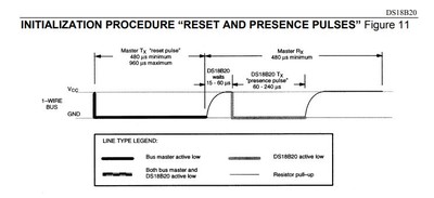

Why Can't My DS18B20 Always Initialize?
11/29/2019 8:43 AM
// Delay 2 microseconds subroutine (12MHZ)
void delay_2us (unsigned char i)
{while (-i);}
void init_ds18b20 ()
uchar x = 0;
DQ = 1; / * First pull high to prepare for reset * /
delay_2us (24); / * delay it a bit * /
DQ = 0; / * pull the level low, delay at least 480us * /
delay_2us (240); / * Delay here 480us * /
DQ = 1; / * After the reset signal is given, pull the level high and wait for the existence pulse * /
delay_2us (30); / * Delay 15 ~ 60us, here delay 60us, give the existence pulse time * /
x = DQ; / * Read existence pulse * /
delay_2us (240); / * Read the presence pulse, the low-level signal whose presence pulse is at least 60us to 240us, here 480us * /
while (1)
if (x == 1)
display (1,1,1,1); Initialization failed to display 1111
else
display (0,0,0,0); // Display 0000 after initialization
DQ = 1; / * After reading, the signal is reset, DS18B20 is initialized, and data exchange protocol is generated * /
After tuning for a long time, it still shows 1111.
What is the reason?

https://cdn.sparkfun.com/datasheets/Sensors/Temp/DS18B20.pdf
Is the signal line accessible to monitor with an oscilloscope?
The datasheet specifies 480us minimum, try increasing the delay.

I adjusted the delay and the problem was solved! Thank you!

In addition to Rixter's answer make sure you have a bypass capacitor near the device.
