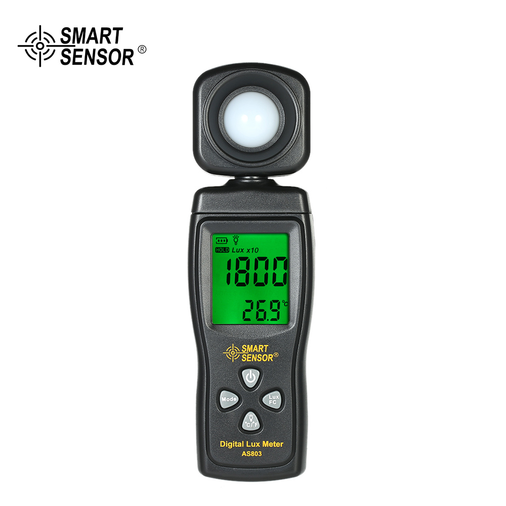

12/04/2019 6:09 AM
Hello and thanks for your good intentions.
Getting the LED to light within the nominated parameters would be directly available from the supplier, with probable 5V DC, 12 V DC and some other options.
To find your energy intensity in the target area (remember to compensate for the "thickness" of the child) I would suggest that you contact a local photographer who will have a "near enough" light meter and then adjust the spacing and height to achieve your intended outcome.
The manufacturing tolerances for LEDs and the other components of your proposed arrangement will thus be reduced to the single error in the reading instrument.
