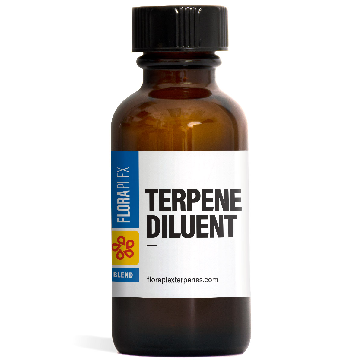

Posts: 33394
Re: Changing Concentration of Pine Oil
12/27/2019 11:18 PM
Terpene Diluent would be the best way to go...for purity
...though probably not for cost...
ref link..
