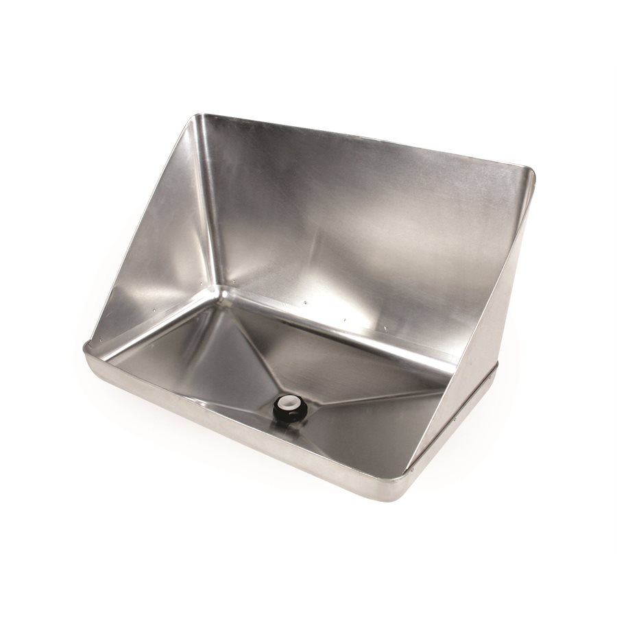

How about a stamped Aluminum pan?
$61 on Amazon....haha Not an exact fit but possibly adaptable...
What is it?

Well... that's the general idea, but this is part of an already existing product that we make. I'm just tackling some issues they've been having with the design, like all the liquid not draining out when needed. Most of that was because they were inserting the pipe into the drain hole and welding both sides, all around. Obviously, that leaves a bit of a ridge sticking up on the inside. So I'm just making the hole smaller and welding the pipe to the outside surface. Making the cross break will just add to the draining ability. And I believe I'll flange the hole downward, like was suggested in another comment, to super-charge the improvement. This should all work significantly better than the original design. In fact, it should work perfectly!
