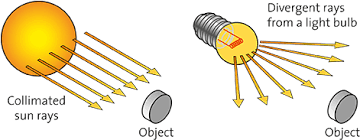

Thanks. Could you elaborate More specifically on what bulb/ lamp could work with a magnifying glass and why. I have a 1000w stage lamp which couldn’t produce a burn. 1500W halogen? Incandescent? What would you be trying to reproduce At 1500W. The most powerful lamp I know of is the 5K fresnel at 5000W
Posts: 9938
Re: Artist in Need of Solar Theory: Search for Poor Mans Laser
07/02/2020 10:17 AM
There is a reason that sunlight can be focused to a point with a magnifying lens. The light from the sun is collimated, that is, the rays from the sun are all parallel (within 1/2 degree). If you are far enough away from your stage lamp for the rays to be reasonable collimated, you will be capturing only a small part of the 1000 watts.
The key to producing a burn is concentrating as much energy in as small an area as possible (energy density). A lens cannot direct the light rays to a point if they are not either parallel or emanating from a point source.
Laser light is highly collimated, and even a few watts of power can be concentrated to a tiny spot to produce a burn.

If you fabricated a 1500w lamp that collimated parallel rays. Would that work?
Posts: 9938
07/05/2020 10:15 PM
Yes, it would, but it is easier said than done. First, you need a very small source so that all the light is emerging almost from a point. You need a lens or parabolic mirror to capture as much of that light as possible and reflect or refract it into a parallel beam.
Due to the size of the source and imperfections in the optical system, the beam will not be perfectly collimated. The result is that your magnifying lens will focus the beam into a larger point than if the beam were perfectly collimated and the beam will be expanded enough that your magnifying glass will only capture a small portion of the energy. Compare the expanding beam from a searchlight to the pencil beam from a laser.
Bottom line: The Laser works much better.
