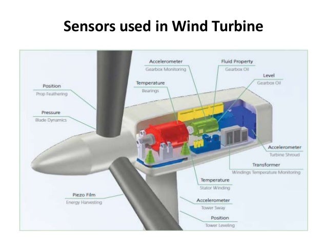

Wind turbines average maybe 20%-25% capacity factor ...
All the wiring and generating connections and equipment are sealed in those little houses on the wind turbines, and air conditioned to help control the corrosive environment...
