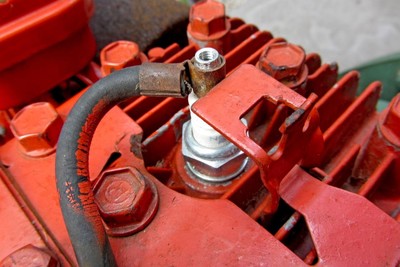

Magneto ignition on an old Briggs & Stratton lawn mower engine WILL get your attention. Back in the day, the "kill switch" was a little "tongue depressor" of steel that shorted the spark to ground. Carelessly get your finger between the shorting bar and the spark plug and whamm-O !
