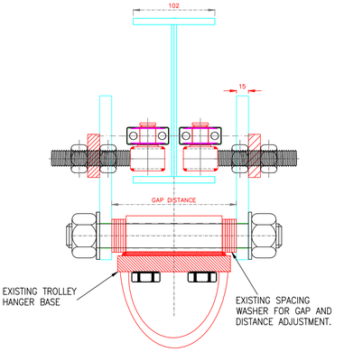

Dear Guys.
Please refer to the photo attached. I have some mechanical problem that I need to settle. The photo show the trolley car hanging on the I-Beam of 100mm width with driving and non driving wheel.
It has 2 running I-Beam rail. The inner I-Beam rail is where the driving wheel with electric motor mounted on it and the outer I-Beam is just the follower free wheel. The inner I-Beam is badly wear off and I am proposed to replace it with a new H-Beam with flat run way surface. All the wheels will be fabricate with a flat surface.
The only part of the rail, I am concern is at the end of the rail, there is a bend of 914mm radius for the Trolley Car to cornering back to right side. Is my proposal is acceptable to replace the I-Beam to H-Beam.
I am not a mechanical background base but I need all the advice from all the professional out there. If any person know the manufacture of these Trolley Car, please let me know as I try to look for the manufacture. I heard those equipment are from Spain.

I am concern about the trolley when it make a turning with the turning radius of 914mm. Base on autocad drawing it should not a problem but weather the trolley car wheel will able to make a smooth turning with H-Beam instead with I-Beam. With I-Beam the trolley car wheel have some flexibility for swinging as the I-Beam has a slop of maybe 2 to 3 degree slop where the H-Beam are flat.

You might actually get better wear with a flat flange (WF section) as it will be easier to get line contact between the rollers and the flange, rather than likely point contact with the angled rollers for the S section. I don’t see why a flat configuration would track any worse than angle, providing your turn radius is large enough to keep the trolley from contacting the web of the section while in the turn.
Two driving wheels at the same speed on the same axle location will end up digging up the rollers & beam flange as you make the corner. One driving wheel may not get you the friction you need.
I worked for 8 years in a paper mill with a similar size beam (S section) carrying 5000lb rolls of paper with one 90 degree bend. The trolley had an electric hoist Shawbox, and it really needed to be replaced twice in that time, the rail, that is. The hoist would need to be rebuilt twice a year, maybe 30 trips per day. I think the hoist drove two wheels, the turn was always chewed up badly.

Thanks for your suggestion. I am also design some guiding wheels to guide the driving wheel so that those wheels are maintain the same distance during making the turning at the 914mm radius turn.

Thanks for the Idea. I have design a set of guide rollers as picture attached.

This is a tracking problem. Start by turning it upside down.
<...All the wheels will be fabricate with a flat surface....>
Railway tyres are coned generally at 1 in 20, less so for ultra-high-speed lines, so that the wheelset stabilises itself on the track. When it gets to a curve, the wheelset tracks to the outside of the curve so that the outer wheel is running on a bigger diameter than the inner wheel, thereby imparting some turning action. To reduce the prospects for wear, the rails are inclined inwards at 1 in 20 as well.
Then turn it back the right way up for this application.
That's the reason for using I-beams as depicted in the diagrams above, with an inclined running surface. It wouldn't be a surprise were the treads of the wheels of the existing equipment to be coned.
Were an H-beam to be used instead, then the tracking and stabilising action at the tread of the wheel cannot happen, and something will be needed to prevent unwanted parts colliding with and scraping along the central web of the H-beam, exacerbating wear and reducing the intervals between replacements. This action is further exacerbated were the wheelsets to have a flat surface instead of some sort of coning, as in railway applications outlined above.
Now, if there is already some other sort of stabilising mechanism in place then all well and good, though that isn't obvious from the posting.

Because of the combo of straight and curved rail segments, there will be scuffing somewhere. Sloped rail sections with coned wheels will minimize scuffing on the curves, whereas flat rails and wheels will be better on the straightaways.
Instead of hardened wheels, which guarantee track wear, you might consider elastomer-rimmed wheels, with a periodic renewal schedule.

flate rollers with bead wear: surely, modify to spheares! and use verticle axle guide rollers similar to that system crane builders use.

Looking at your setup I would think that with a turnaround point as sharp as that, it would be better to drive the outside wheel. For a starter irrespective of what way you go with the beams it may be an option to turn the cars around to accomodate the drive wheel on the long traveling path on the turning point. From you photos it seems that there is only one load bearing wheel on each side. A nearby photo of the load bearing wheels will help.
