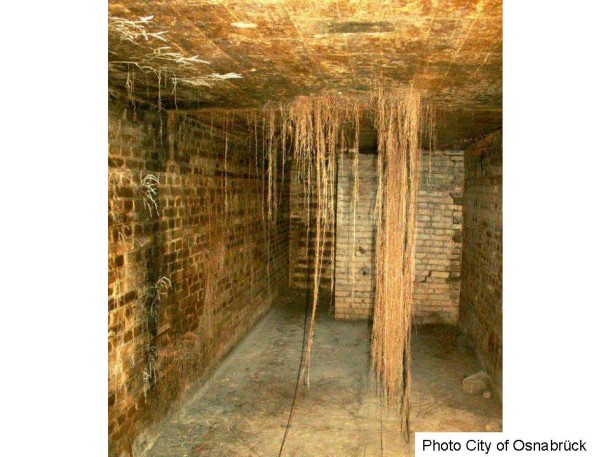

Hi,
Will the tree that is growing on top of the culvert, as shown in the figure shown below, damage it?
If so what types of damages can be expected?
Kind regards,
Job Thykkoottathil

I would expect the weight of the tree will not be the predominant problem. A twenty-five-foot-tall tree with only twelve inches of soil for roots will not be very stable to wind loads.

Tree roots can grow through rocks and concrete.

My guess would be the roots will get under the top slab and break it away, such that if the tree blows over it will lift up a section. Conversely the roots breaking into the culvert may make the tree stable enough to withstand the wind, but will presumably trap debris and eventually block the culvert.

Yes,the roots will eventually break the concrete.
I have seen many road ways lifted by tree roots from trees over 30 meters away.
Any minor imperfection of the concrete will be exploited by the roots,and as they expand under hydraulic pressure,it is like a slow-mo controlled explosion.A friend described it as :"Slow power."

No, but the roots of that tree will.
the roots will grow in the smallest of cracks, and as it grows will make it expand like a wedge.
