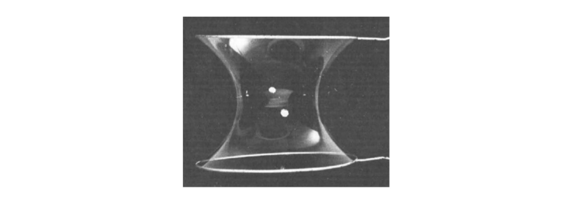

In general the surface may not be spherical and will have two principal radii of curvature, R1 and R2.
https://en.wikipedia.org/wiki/Laplace_pressure
An interesting example is where both sides of the surface are open to the atmosphere and the delta pressure = 0. The curvature could be zero (flat surface, R1 = R2 = infinity) or one radius of curvature could be negative and the other positive as illustrated in the picture below (catenoid of revolution).

Re: Calculate Surface Tension
12/23/2021 9:01 AM
If you mean the skin has thickness t, uniformly stressed, by a simple force balance, skin tensile stress = X*Y/4/t psi.
If you mean surface tension as normally understood, this = X*Y/8 lbf/inch circumference. The extra factor of 2 because each surface contributes.
If it's a soap bubble, good luck making one 4m diameter!
