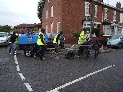

This is one fifth of a horsepower shifting 2000lbs+ at 3 feet per second round Birmingham. He does notice the speed ramps.

I'd love to know what's going on in that picture - it's brilliant !

Small pony shifting 2000lb generator for the BALSALL HEATH CARNIVAL in Birmingham. Nobody had a tow hook that fitted so we hooked it to the saddlechariot, which was hooked to Henry. On the basis that a shire horse is one ton, and Henry is approx 1/5th of a ton, he is generating 1/5th of a horsepower.

Thanks Simon,
Henry looks like a real character - you must get hours of pleasure. I really liked the shots you posted earlier on the beach ; totally cool.
