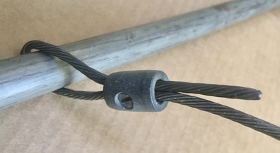

The wall thickness of the frame tubing is 0.04 inch, and 0.98" in diameter. I want to make it stronger by adding to the hollow area of the tube using a mortar mix injected. The structures are prone to collapse due to snow load issues and strong winds. Would my idea work to help the original posters question ?
Re: How to Strengthen Tubing Mechanically
01/16/2022 2:12 PM
WOW! Only 0.04" wall thickness, and less than an inch OD! That's clearly NOT designed for snow country. While filling the arches with mortar will prevent the tubes from collapsing, you'd have to fill them upside down and already assembled (I'm assuming that the arches are delivered in sections). Unless the mortar contained a significant content of some kind of fiber, it would not add significant strength to the arches (beyond collapse prevention), and it would make them several times as heavy. Depending on the density of the mortar, it could make each arch weigh around 5 or 6 times as much as the hollow arch. ...and that's assuming they are steel tubes; if they are aluminum, they could easily weigh 10 times as much.
Also, to get even close to complete fill, you'd have to use a very thin (low viscosity) mortar mix. I don't know what may be available now, but the mortars I've used in the past became quite weak when mixed thin. You'd have to fabricate a support system to hold the arch while being filled and until the mortar cured. Once cured, I suspect you would not even be able to put the filled arches in place without breaking the mortar.
Here is an end view of my suggestion:
Securely tie a wire/cable from each longitudinal tube to the next (Black lines in the illustration) at each arch. This will stabilize the structure significantly, while adding very little weight.

Excellent ! I think I see how it works. The downward pull pre-stresses the middle of the arches forcing the top and mid sides to use up/ shorten flex area. The resulting strength should be between 1/3 to 1/2 as much greater. Economical too.
Getting the right tension will be a little tricky but doable. Some cheap ratcheting load ties should work and remain adjustable.
Thank you !!
01/16/2022 3:38 PM
Good. I would have the wires just barely taut in calm conditions. I forgot to mention: If you or anyone likely to enter is very tall, it might be a good idea to hang some flags from the top wires.
Actually, I was thinking of wires/cables with turnbuckles. If you are thinking of the nylon straps with ratchets that are used to tie down loads, I'd say NO. Nylon stretches too much.
Something like this:
What I know as "aircraft cable" in something like 1/8-3/16" diameter. There are crimp-on cable clamps that are probably cheaper than the setscrew type shown here. You could also use guy-wire, but it would stretch a lot more than the "aircraft cable" under heavy load. I'd use two of the crimp connectors at each cable end.

I had made it to aircraft cable already. Economics of project. Harbor freight has it 5/32 x 100 feet for $13.99 and a max work load of 600 lbs. Coupling nuts to connect to original frame bolts, then a threaded, forged eye bolt to run the cable through.
I will be having treated 4x4's attaching bottom rails of the frame to. Corrosion prevention. Plus it gives a good structure to anchor it all down with. Ground screw anchors with lags to attach them.
I'm wondering if it might be beneficial to run the cables on down to the treated 4x4's. Then tie off the cables with lag eye bolts secured in the wood 4x4's ? Wind comes from all directions plus it needs to be out in open as much as possible to get max sunlight in shorter day months of year.
The unit comes with 2 rope ties that go over the fabric. Intended to hold it down. Plus some inside ties connected to fabric which tie off on the frame.
I intend to lay down heavy ground cloth, frame up the structure on the treated 4x4's all on top of ground cloth. Have the frame all tight and attached to the wood. Then apply the outside cover. Align as much as possible, and stretch lightly against frame. Use the extra tail they left at bottom to bring to inside around the bottom of the treated 4x4's, staple and use wood weather stripping nailed on to keep it tight. I will need to reinforce the ends with some wood frame, as a 10' x 7' area makes a great sail or rip point.
Bring the cables on down or no ?

"I'm wondering if it might be beneficial to run the cables on down to the treated 4x4's."
Good idea, IFF the cables are attached to the bottom of the arc in a way that they can't slip there. Best would be if the 4x4s extend up to the bottom of the arc, and the eye bolts were very near the outside top of those posts.
