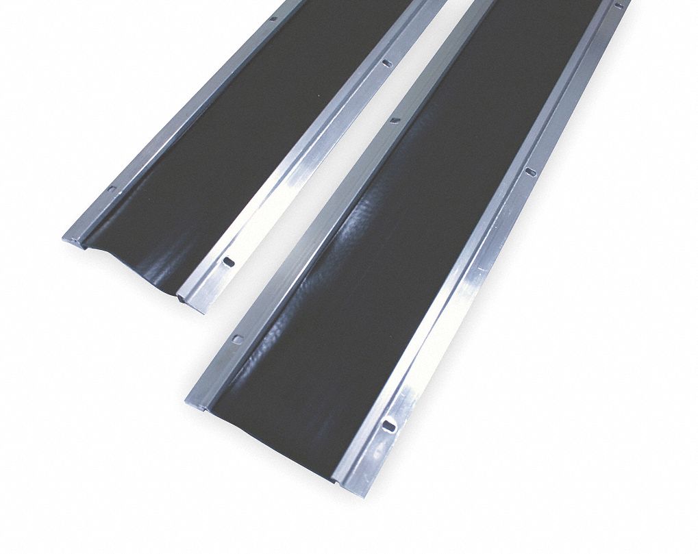

I've used Grainger P/n 2RRP8 Santoprene seal kit with great success on doors with uneven gaps. It creates a convex bulb that conforms to the gap.
Nothing is fool-proof to a talented fool
