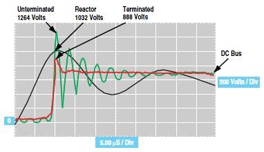

At Rockwell's literature site, there's an Allen-Bradley document where they describe the problem: excessive ringing on the sharp PWM line IGBT-switching edges, from the VFD and the long motor cables, and they show 'scope waveforms.
They show a 1264-volt ringing waveform (they say it can get as high as 2500 volts in a 575-volt system), which could be reduced to 1032 volts with a reactor, but they do better with a "terminator," placed at the motor, which clamps this to a safer 888 volts for a few microseconds only, and no ringing.
To solve the motor-winding-damage problem they suggest the use of their 1204 Motor Terminator, and the document gives details about selecting the right model, its installation and use.
