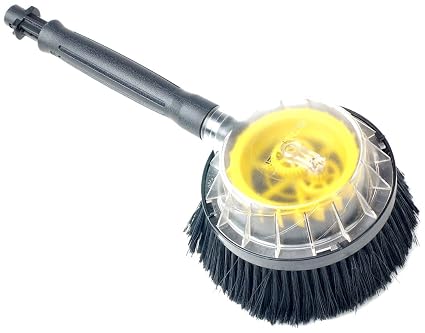

Have you looked at the innards of one of these? Got your turbine, got your gears . . .

That looks cute. Only problem with it is it's designed for high pressure/low flow of a power washer.
I'd like to take one of them apart.

Right - I just meant conceptually. I don't think it would deliver the power OP wants.
You can probably buy one cheap on eBay. I have several in my garage I listed several times and never sold, even though I undercut everybody else! I laugh every time I see one in a big box store priced for several times more.
Re: Suggestions for a Water Powered Mechanism
