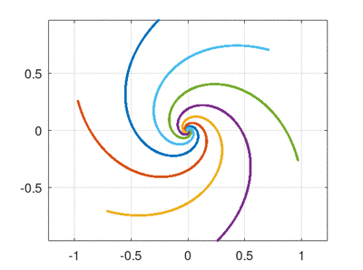

Correction...
Software bug...my apologies...
Octave simulation, .001 second step size
Time = 120 seconds = 2 minutes
Speed = 30 mph = 1/2 mile/minute
Distance = Time x Speed = 1 mile

The dogs clearly don't run in a straight line, they run directly towards the next dog at each instant in time.
Clearly the dogs always form a square: consider two "consecutive" Squares
In the limit as you consider two squares very close together it is clear that each dog runs exactly the same distance as the square has shrunk.
So the dogs run 1 mile each: they meet in the middle after 2 minutes.

For further info, the curve each dog follows is a logarithmic spiral.
SE's post 4 shows a nice rendering known as "Huddy's Doodle". It consists entirely of straight line segments, but observers don't always believe that.
