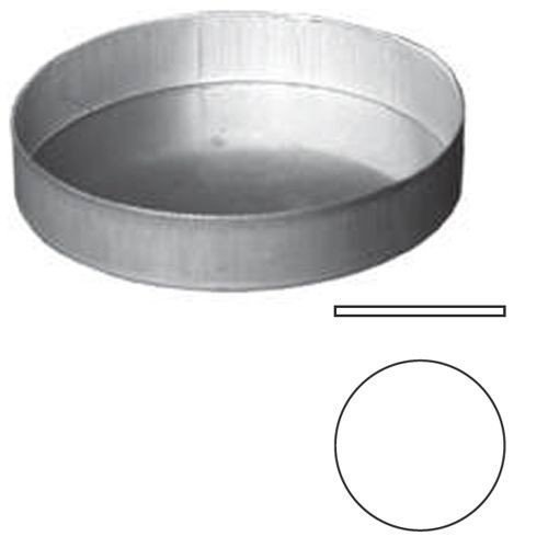

A few years ago we had a new Class A chimney built, because the old furnace vent pipe traveled about 15 feet downhill to our masonry chimney and, according to our chimney guy, had horrible draft properties. The new chimney comes out the opposite side of the house, so we've been left with a wide open 7" vent pipe that starts at the top of the old chimney and is kind of hanging open above the furnace.
It just occurred to me that squirrels and other vermin could find their way in to the cellar via the top of the chimney, and I'm sure I'm losing some heat with the open pipe, so I'd like to cap it. Would a product like this be the most appropriate means?
Round Gas Vent Tee Cap
Pathfinder Tags: cap chimney vent pipe

Short of removing it, yes I would think a cap would be necessary....are you sure the vent isn't being used as a fresh air intake of some type? In that case a screen and cap would be the way to go...

I'd cap both ends. But, that's just me.

Even though the chimney is not used, it's still a maintenance nightmare, not to mention a prime source for water infiltration. If this is a chimney that goes up through the interior of the house, the best solution is to remove the bricks, flue, and mortar above the roof and shingle over it. If this is not desirable, I agree that it should be plugged and capped at both ends.

Have to agree with you about plugging and capping!! Cheap and quick....
I would personally not remove it as you never know what might happen in the future and the cost of removing it is simply a waste of money....

You may want check if this vent serves indirectly as an air supply for the furnace.

If it was me I would just stuff it full of old rags and stick a cap on it then maybe spray foam the whole thing over to make it weather tight.
Who knows when the day will come that for whatever reason someone may want to put it back into use.

If this vent pipe is directly over the furnace, it may be feeding fresh air to the furnace rather than sucking the warm air out of the heated rooms in the house.
I had a fresh air pipe (going through the side wall) to feed air to our furnace because the house was built 'air-tight'. It works for us, the pipe is screened at the outside, and dumps fresh air directly over our furnace.

If it is a brick and mortar chimney you may want to simply use a large cement patio stone to cover the top. A little mortar or epoxy under it and it will stay put.

To cap the top of the chimney use spray foam to form a backing for thin mortar cap on top of it. That way if it was necessary to reuse it will not be difficult to remove.

An unused chimney still draws, and will suck the heat out of your house. I would put a metal cap over the top, fasten it down squirrel tight. Once the chimney is capped, you should be able to remove the pipe and close the hole in the chimney with brick and such.

I don't know where you live, but I would be careful how you "cap" the top of the pipe. Living in New Hampshire, having some very cold days in winter, placing something with any weight on it can cause a crash when the "cap" falls due to cold/heat loosening the attachment.
