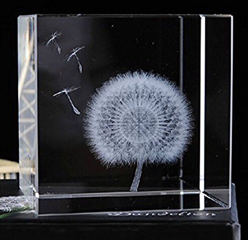

Allow me to elaborate further:
Imagine an optically clear sphere,or cube,wherein co ordinates have been assigned,on the nano scale.
imagine also 3 (or more) lasers with the ability to illuminate each co ordinate point independently.
These points require the combined energy of at least 3 lasers to change state from one color to another.
Once changed they will remain in this state until 3 more lasers,of a different frequency strike them.
The state of the "dots" could be read by a separate frequency.
This would constitute a very dense 3D memory module.
There may already be such a memory,but I have not heard of it yet.
Which would not surprise me.

Re: Reversible Color Change
05/23/2016 10:29 PM
It would be cool if the data could be interpreted into art via laser etching...
Your entire music collection in a 3-D picture of something....
