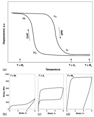

I thought about how the stresses that are induced over time (Which is the drive mechanism), how this would effect the life of the drives., I came across this paper.
Reinforces what you pointed out.
Which looking at the efficiency that was presented one could extrapolate power output using known given inputs, (such as CSA of Nitinol, ΔT, etc...). Keeping in mind this is still a lab model.
a schematic displacement–temperature curve under constant tensile force for Nitinol that indicates the transformation temperatures as well as the three general regions for which fatigue data have been generated. The monotonic stress–strain curves at test temperatures: b below Mf (100% martensite), which is characterised with a low stress plateau and a large remnant strain after unloading from 6% strain; c above Af (100% austenite), which is characterised by an increased upper stress plateau (transformation from austenite to deformed martensite), an unloading plateau (transformation from martensite to austenite) and a return to the original shape; d above Md, the temperature above which plasticity is the dominant deformation accommodation mechanism. After Pelton et al.7
