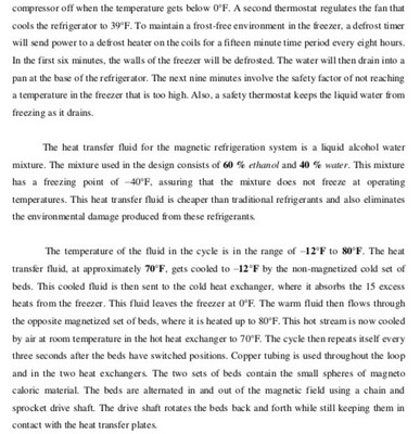

I have been contemplating the possibility of a magneto caloric nitinol engine...A nitinol wire wrapped in a praseodymium or gadolinium or perhaps even an engineered material that would have a fine trigger point temperature, that when the material was passed through a magnetic field would gain enough heat to trigger the nitinol then immediately back....any thoughts?

Since this is not strictly a heat engine, you might find a surprisingly high "thermal" efficiency! I suspect you are wanting to recover electrical energy from a magnetic field, and a low power input torque to keep this thing moving through the field?

I just reread your post. Do you want a magnetic field to cause a rise in temperature to convert to motion using Nitinol? That kind of sounds like an inefficient process!
When Nitinol changes state it takes an influx of heat, not unlike melting ice, and any work it does requires addition of heat with an efficiency limited by Carnot.
Heat generated by the magnetocaloric effect is a result of the increased energy needed to magnetize the Gadolinium and that energy needs to be supplied by moving a magnet or energizing an electromagnet.
But if you could get it to work, it might make an interesting toy.

Well I was just working on the concept...let's say a swinging pendulum with a spring that would give a slight pull on a wire to sustain the motion....the spring made of nitinol coated with gadolinium or engineered material that gained heat upon entering a magnetic field supplied by permanent magnets >1 tesla...now there is an electrical surge generated as well, although quite small, could be supplemented with a copper coil possibly for some assistance....But the whole idea is to have the heat generated by the permanent magnetic field to effect the gadolinium which would then trigger the nitinol...some environmental temperature control may be necessary...but the guy says that 10°K per tesla fluctuation may be possible, this seems a reasonable amount to trigger the reaction....

My understanding is that as the temperature of the nitinol rises, a phase change occurs, martensite to austenite, and this takes heat energy. It takes even more heat energy if the nitinol has to do work. It's analogous to the heat of fusion required to melt ice.
https://en.wikipedia.org/wiki/Nickel_titanium
Gadolinium gets hot when it's magnetized just like gas gets hot when compressed. In both cases this requires energy input. If the pendulum is swinging through a magnetic field, then the energy will be removed from the pendulum's motion.
