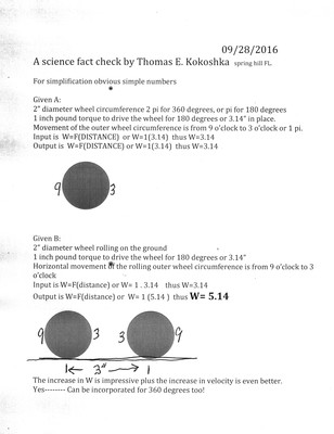

Science Fact Check Does 3.14 = 5.14

Rejected. Scientific and engineering fail for using undefined units, formulas and parameters.
What is W? Why is there no unit for the result?

W = work

Ok let me try to figure it.
First one is a wheel that turns on the spot with a certain torque.
The work needed for it is 3.14 whatever unit.
Then the wheel is turned and moves adding some distance. While you say that this happens at the same torque you now are adding a distance. This adds to the work that went into the system.
No?

Yes! Yes! The first wheel A is what we know and understand as 1/2 turn a movement of 3.14" ... with a potenical output of 3.14"
The second wheel B represents that wheel rolling 1/2 turn or 3.14"
Measure the distance traveled from it's start of 9 o'cock on the circumfrence to the outside edge when it stops 5.14" ... you can see the 9 and the 3 switched position. that is a fact. If the wheel would travel 360 degrees all would cancel out to normal movement what we all understand. The wheel must stop at 1/2 turn to measure 5.14"
I did not think this would be so difficult to understand ... your the 1st one to get this far.

Sorry Thomas, you're the only person here who doesn't get it.
Start with your flywheel apply your torque for a given angle; when you remove the drive the flywheel will be spinning; it won't stop if there is no friction.
Calculate the total kinetic energy.
Start with your cart wheel apply the torque for the same angle; when you remove the drive the wheel will be rolling.

Where did the 5.14 come from? The center of mass of the wheel moved only 3.14. It doesn't matter what some single point on the circumference did.

Look at the drawing again.
think out of the box ... 9 o'clock to 9 o'clock is 5.14 "
3.14" is center to center
utilize circumference not center for 5.14

Incorrect procedure.
Re: Science fact check does 3.14 = 5.14
09/28/2016 4:51 AM
Using your logic, the result could also be 1.14 (3 o'clock to 3 o'clock).

I am measuring only from 9 to 9 as the wheel rolls and stops. this is 5.14" or 1/2 turn ... no more no less.

  1. The 3" should be pi"
  2. I am assuming the 1 pound inch is torque required to accelerate the wheel.
  3. If the 1 pound inch is for acceleration, there would be an additional torque required to accelerate the mass of the wheel in the linear direction.
  4. In the first case, you have energy in rotation, in the second case both energy in rotation and translation.

The bottom illustration shows 3" displacement. If the wheel rolls on its circumference, it should roll 3.14 inches, but that is irrelevant.
If you apply a force to an object with mass, it accelerates. If you apply a torque to an object with moment of inertia, it undergoes angular acceleration. If you apply torque to a wheel that is resting on a surface, it both accelerates due to the horizontal force between the wheel and the surface and accelerates the rotation of the wheel.
After 1/2 turns, the wheel would continue to roll until a torque was applied in the opposite direction to cancel out the angular and linear momentum.

In your first example you have the distance a point on the circle moves around the center.
The second is the distance in a straight line from the point to point after the circle rolls
Your comparison is flawed.
With your logic if we then turn the first example 360º we have a travel of 6.28". In the second with it rolling it's still 5.14". So by your logic any farther turn and you lost work.

Yes ...Wheel A is an example of 1/2 turn around a center.... movement of 3.14"
normal conventual rotation.
Wheel B is a 2" wheel rolling on surface for 1/2 turn or 3.14" and stops ..no more no less.
the 5.14" is a measurement off the outside circumference movement.
fact the is distance of 5.14" outside measurements.

It does not matter how far any particular point travels, but rather how far the center of mass (the average of all points on the object) travels.
As at least one prior post said, if you travel one more half-revolution, that same point on the wheel, which you say traveled 5.14 inches during the first half-revolution, will only travel (6.28-5.14)=1.14 additional inches during the second half-revolution, giving an average of 3.14 inches per half-revolution.

I think we have here a typographic error where you meant to have output as:
W=Fd =1 x 3.14" =3.14, not 5.14 as stated in your original post.
This is beyond ridiculous to add further speculation on top of the obvious error.
It is physically impossible to gain work between input and output.
By the way, in the machine of the first kind, no external work is done, all the input work is expended as heat, so W=0
In the second case, the object being a wheel is moved through one rotation.
input W= 1 x 2 x 3.14 =6.28 not 5.14, (the arc length is 1" x 2π).
This is also the output work in this case, ignoring friction, etc. There is nothing to see here, move along please.

9 o'clock moves 5.14 inches, 3 o'clock moves 1.14 inches, the center of the wheel moves 3.14 inches. Any two diametrically opposite points on the wheel move an average of 3.14 inches.

I think that is exactly where the poster has a fallacy in thinking. He assumes the movement of the wheel is 3.14 but a point initially at 3 has moved 3.14 + 2 times 1 = 5.14. That of course is correct but is does not mean anything. Point 9 moves 3.14 - 2 times 1 = 1.14 so the sum of both points 3 and 9 is 3.14 just like the wheel. I am repeating what was already said by Rixter just to hopefully make it clearer. He beat me to it.
The sum of all points is 3.14. For calculation involving work it is the wheel that counts not some point on the wheel. The wheel is a unit with a mass at its centre and that mass counts for motion calculations. Centre of mass. The motion of the sum of all points is 3.14.

Exactly, you beat me to it. If it rolls along another 1/2 revolution every point on the disc has travelled 2*pi inches, because it's the same as sliding it along bodily.
It's a kinematic problem, torque, work etc are irrelevant.
