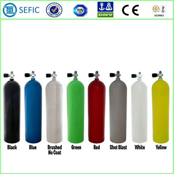

In 7 inch length and 7 inch round aluminum tank how much air (psi) we can compres?

If the tank was manufactured as a compressed air tank then look at the manufacturer's data.
If the tank was not manufactured as a compressed air tank then please refer to this site for a better understanding of what is going on.
If this is a homework question then you did a really poor job of asking us to do your homework for you.

No, hahaha actualy i am working in a project for air rifle so i Want to know about air compres, the tank was not banded its is lighter refile tank but the condition is looking quite good

What color is the tank?
Re: Air Compresser
11/16/2016 1:46 PM
And the tank thickness is?
No guarantee this is not a custom tank built from scratch.
Re: Air Compresser
11/16/2016 2:10 PM
Any metal tank is manufactured for purpose...If that tank is specified as aluminum cylinder 7" in diameter, then the pressure required will determine the thickness and composition of the materials, as well as the specification with which the tank will be constructed and certified, this information is generally required to be stamped on the cylinder( ISO 13769 in the USA), and time limit between recertifications, as well as maximum useful life....So there is no answer to your question, it depends on the aluminum used, any treatments of that metal, the thickness of the metal and the construction methodology of the vessel, the age and compliance of the tank...I would add without this information you can not legally pressurize this tank....

The volume of your tank is 7 x π x (7/2)2 = ~ 270 in3
liquid air has a density of 0.87 g/cm3
and normal air has a density of 0.001225 g/cm3
so you can get 0.87 / 0.001225 = ~ 710 times as much liquid air in the tank as normal air.
So 270 x 710 =~ 192,000 cubic inches =~ 111 cubic feet.
Of course others have alluded to other constraints like the strength of the vessel; the capability of your compressor, and, most importantly safety.

If it is a light thin walled container then I would not exceed 100 - 120 PSI but if it was pre-filled and emptied and you are trying to repurpose the "tank" then what you're doing is probably dangerous or even illegal if you do not have the manufacturer specifications available!
