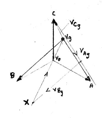

How to measure the Neutral to Ground voltages in ungrounded system?
If VT's are connected phase to ground it measures phase to ground voltages. To determine the neutral shift one need to know the neutral point. How is the neutral point derived?
Blackburn book says, Vng=V0. Thus neutral shift is the zero sequence voltage. but Isn't Vng=3V0?

There is no neutral point in an ungrounded system.
If your ungrounded system is powered by a Y transformer winding [a grounded mid-point/common point of the Y would be called neutral] one must suppose you mean the voltage to ground of the centre of the star.
I think the Vo in the book is the physical voltage between the common star point of the winding and ground.
If you add the three VT voltages together, then the symmetrical positive and negative sequence voltages sum to zero, leaving the additive zero sequence voltages.
I have drawn a diagram below graphically summing the 3 VT voltages. In a real installation, the secondary windings of the VTs could be connected in "open delta" - VTs may have two secondary windings so both the "Y" voltages and the "open delta" voltages can be got simultaneously. For "open delta", "hot" of one VT secondary is connected to "ground" of the next, leaving one corner to be connected to meters or relays.
The symmetrical voltages to "star point" Vo are A-Vo, B-Vo, C-Vo.
A ground point Vg has been selected at random, with voltages to ground, the VT voltages VAg, VBg, VCg.
I have drawn in vectors VAg and VBg transposed to sum with VCg as the secondary winding voltages of VTs would sum. The open arrows > indicate their directions, please excuse the extension line of VAg, which I should have rubbed-out.
The sum of the 3 VT voltages is X-Vg. Note it is in phase with the Vo to ground vector and 3 times the length.
If the system were fed by a delta power winding or generator, the neutral point could be only theoretical but usefull as a concept to quantify unbalance.
Obviously, voltage from Vo to ground, results in a non-zero open delta voltage. If Vo were connected to ground by a resistor, such an offset could indicate an earth fault.

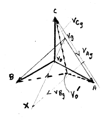

The "Anonymous post" question was about "How to measure the Neutral to Ground voltages in ungrounded system?". There is not any neutral point, the centre point of a star winding which would be earthed in a system with neutral is the nearest, but since the proposal is that "Vng = Vo", this requires answer.
I have added a point Vo' with star voltages A-Vo', B-vo', C-Vo', which still give a symmetrical Δ voltage ABC.
Note VAg, VBg, VCg are unchanged.
But Vo' to ground is not the same as Vo to ground.
So the VT voltages to ground can give you a zero sequence voltage Vo, a useful single number unbalance indicator, but they cannot tell the middle "neutral" voltage of the Y winding.
Conclusion is that Vng ≠ Vo if the system is not earthed by connecting the neutral to earth through a resistor.
