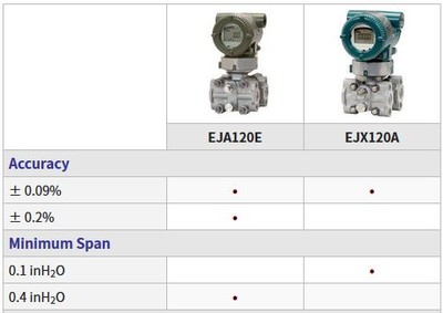

Re: Low Pressure Measurement
12/20/2016 8:20 PM
Its a bit fresh and probably not made into a sensor, but this is what you are looking for.

12/21/2016 3:49 PM
My take on it is that the units are wildly incorrect.
0.004 bar (4 mbar) is 1.6 in H2O or 40.8 mm H2O, measured with a draft range transmitter
0.0004 bar (0.4mbar) is 0.16 in H2O or 4.08 mm H2O still measurable with a high end draft range pressure transmitter
