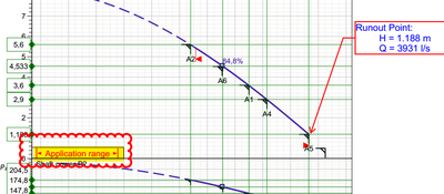

*** My problem
I get pump curve from the commercial department of a major manufacturer.
There are many indications that the curve has been changed.
I need the knowledge to be able to build the pump curve (same manufacturer) to be able to check the curves it on.
Moreover, I need the method to calculate the vibration, noise, "runout point" of the pump.
Your contribution will help me make the right decision when selecting a pump

Re: Pump Curve
01/20/2017 12:07 AM
What would be "many indications that the curve has been changed"?
That post is complete nonsense.
Posts: 31
Re: Pump Curve
01/20/2017 12:34 AM
Published on the website
Many and many
Give customers (27/01/2016)
My country - corruption, corruption and corruption
Re: Pump Curve
01/20/2017 12:56 AM
So? The first curve doesn't look related to the others at all. In any event, if the operating ranges are different, then the curves will be different, but not necessarily changed. In the third diagram, what's that nonsense about 36>40?
Posts: 31
Re: Pump Curve
01/20/2017 1:10 AM
These are 3 of the same pump curve (same type, same weight, same mouth suction, the discharge mouth, same number of blades, same blade angle, same density of the liquid ...)
"36> 40" is the distributor
