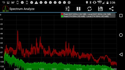

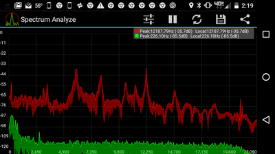

This is what the spectrum looks like with the tuning bar (10-32 screw and nuts) centered on the putter head. (Somewhat muffled)
This is the video SE posted of the ping sound.
This is the unrestricted sound of my putter.
I have reached a very firm conclusion that these don't tell me anything.

I've discovered that the striking force is not consistent and that influences the results. In order to produce repeatable results I must come up with a striker and some type of setup that allows repeatability.

You're comparing the tone of a video whose sound is being reproduced by your small pc speaker to the sound of a tone generated by that same small speaker and using your ear as the judge? Pretty subjective if you ask me. Not that you can't hear but everyone's hearing is different.
If you take a look at my spectra of the video sound compared to the spectra of the sound I produced by real time ball striking, you will see that the actual putting sound spectra is much more complex than the reproduced sound.
I'm going to rely on the sounds made in real time by my putter.

''...you will see that the actual putting sound spectra is much more complex than the reproduced sound..."
