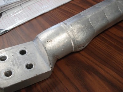

Re: A question for the budding Sherlock Holmes
01/20/2017 9:06 AM
So the solution is to drill a small (3mm or so) weep hole in the bottom of the fence post tube, so the water can drain off.
I have seen similar effects on large crimped-on cable terminals used on electrical station circuit breakers, etc. The cable sweeping down from the bus above to the breaker's bushings is a nice path for the water to run down, which then collects in the natural "cup" of the terminal which has been compressed on the cable's end. If a weep hole is not provided by the terminal manufacturer or drilled in the field by the installer, the resulting ice during winter weather expands and splits the terminal. Notice the bulge and crack down near the pad of the terminal in the photos - a lot of force there!
01/23/2017 11:31 AM
I was aware that at least some lugs have a hole for inspection purposes, but for an installation where water can run down the conductor and into the barrel of the lug, the hole also serves to allow it to drain.
It is often not possible to build a high voltage installation such that the barrel points downward - Usually the bus height is above the elevation of the breaker bushings, for example.
You may think that proper compression of the lug would eliminate all the voids, but if you cut cross-sections of the compressed fitting, you would find all sorts of little crevices through which the water can seep. And water, being the small molecule it is, WILL find its way through them. You cannot crimp the connection enough to eliminate all the voids.
These crimps were done properly, and the connectors were fine when installed two years before the photo. The bulging and cracking was from water that had entered the barrel and frozen, but since the installer had not drilled weep holes (since the Mfr didn't provide them), the ice did its thing. Other lugs with weep holes in different parts of the same switchyard didn't have this problem.
01/23/2017 12:41 PM
Never built a sub or yard where I have lug barrels facing upwards. Not even in the US. Bad design practice allows for upward facing lugs, hence the drawing for the correct connector method.
The hole was originally for soldering, (or if in the US, 'soddering'). The lug was soldered, (wiped), and the hole allowed the installer to enure the lug barrel was filled with conductor and wiping metal. The barrel, when filled, the wiping metal flows out of the hole, ensuring a filled void.
Hence, a water block and sealed lug, just like that!
01/23/2017 1:34 PM
Not necessarily bad design - done by many, and works fine if done properly. Certainly much easier than trying to construct a drip loop in 2500kcm cable, which does NOT bend very easily. If drop loops were included on these connections, it would add at least 6'-8' of additional space needed on each side of each breaker, and in a breaker-and-a-half station would increase the width of the station by 35' to 50'. That's not always easy real estate to justify.
So it's a design choice, and with proper attention to the details, results in no problem.
01/24/2017 7:54 AM
115kV & 345kV. We try to avoid bolted connectors because they have more potential for loose connections and overheating. Of course, there is still the bolted connection from the bushing to the cable lug, but at some point those are unavoidable. IR inspections can catch them, but in a major transmission station, getting an outage to deal with a hot connection can be a pain, so we want as few as possible.
The grease/anti-ox compound is good, but it can never get fully in between all the strands of the cable, and as I said you cannot fully compress all the voids out of it. We do use it, but it is not the ultimate solution.
Anyway, it could be done either way, each with its advantages and drawbacks. Thanks for the input.
