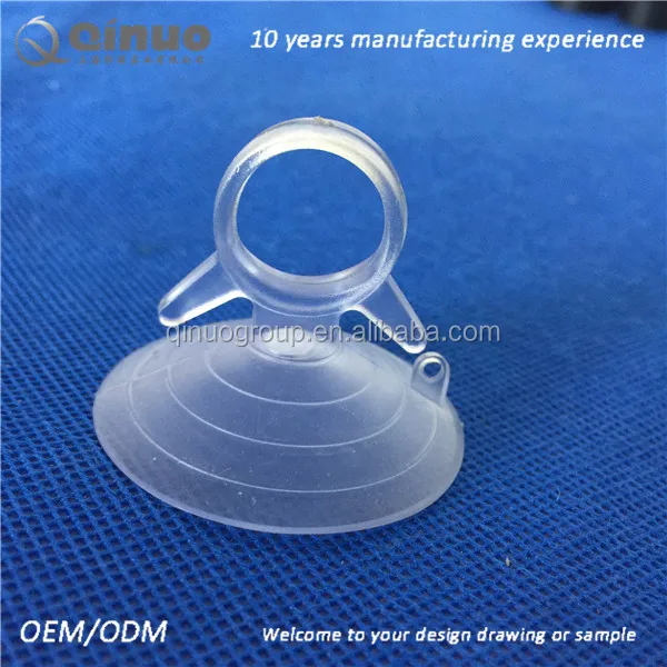

Correct, if I can get a few last things (mainly the flag to pole mount) I would love to share my idea with others. Here are some custom made rubber pieces I have been testing. They work well, but will break/come apart at higher speeds (60+mph).
Re: Fun Project Help!
05/10/2017 9:03 PM
I'd consider looking towards a suitable or custom suction cup assembly..
..not like the one I've referenced in the photo below, but maybe something with a cylindrical sleeve (for the rod)as apposed to a ring etc. I think that with the right material, size, quality and some flexibility between the sleeve and the suction cup you might find that it held the flag ever more firmly under load.
a little misty spray should be all that's needed to insert the pole, but even that might not be an issue.
I'd do some testing by attaching various lengths and types of suitable 'rubber' hoses to suitable cups before ordering a custom sample.
It would also be advisable to find a suction cup capable of operating and staying attached for as long as possible should there be an unnoticed failure of one cup.
A flag beating it self up and dragging is better than answering the phone and hearing about you flag holder design (not mine) causing an accident.
be safe. have fun.
