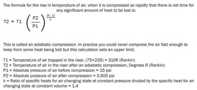

We are amplifying our air system for an aplication from 100 PSI to 200PSI. How would i determine the temperature of the 200 PSI? Is it as simple as P1/T1+P2/T2?

So we currently have 100 PSI throughout our plant. We need 200 PSI in order to run our valve gate system in our injection molds. So we have a booster pump that pumps up a tank to 200PSI. When the gates need opened or closed the pressure is released from the 200PSI tank and then is built up again by the booster pump.

OK, what happens when you pump air into a tank can be modeled as adiabatic compression. Two things will happen: the pressure will increase and the temperature will increase. How much temperature rise depends on the ratio of the specific heats for constant pressure and constant volume.
Adiabatic compression is the limiting case where no heat is allowed to escape, and it will give you the worst case for temperature rise.
Here is an example. You can plug in your values for 100 psi and 200 psi.

Re: PV=NRT
05/31/2017 2:40 PM
Actually, this document is a more straight forward example for Adiabatic heat rise from compression. You can plug in 100 psi and 200 psi.
