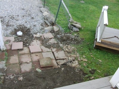

Buried Well Head - Need to Disinfect
06/16/2017 7:33 PM
OK - so before everyone jumps in and tells me how to put bleach down the well, that's NOT what I'm asking about.
I'm trying to figure out if there is a way to disinfect it WITHOUT DIGGING IT UP.
It's a drilled well, 160ft deep.
What I know about it's location is, that it's "under the front steps".
The pipe that comes into the basement is about 5ft below grade.
I don't know the well head depth below grade.
I don't know the exact location.
It was installed in 1985, and the house was not built yet. (there's no reference location from the house other than "under the steps" as told by the previous owner...I have to try to find him too...he's not a friendly guy)
I don't know if it's in a cement casing or if they buried the bare well head.
So anyone ever tried to disinfect a well without being able to open the well head?
Any suggestions about how to find it's location without digging down to the feed pipe and following it to the well? That's how I would do it, but the wife seems to think there's an easier way..."just pull a couple of boards up from the steps and dig down to it." ..."Rent a metal detector and push it under the steps."
Digging is easy for me since I have a backhoe...it's tearing up the front yard, flower beds, bushes, steps, that I'm not really willing to get into.

Testing showed borderline contamination of e coli...it's on the line between acceptable and unacceptable...recommended solution is to disinfect with bleach solution. I've done this successfully in the past...just need to find the well.
Installer is coming next week to use metal detector and pipe locator.
We will open the well, disinfect, place a "casing" around the well head to make it more accessible in the future, as we plan to have the pump replaced.

Well Murphy's law was in effect. I removed the steps to be sure we had access when the "well guy" showed up. The well was NOT UNDER the steps...in front yes, but NOT UNDER!
So we're getting a new pump and new pipe down the well, and getting it sanitized after all that. He's also adding a foot or so of pipe so it will be above ground when he's done. I'll build something around it so we can plant some flowers on it.
Apparently the previous owner cut the well pipe so he could bury it. He used the original cap, which was not rated for burial. He just added a bunch of calk/sealer, which failed at some point, letting all sorts of nasty things in.
Here's the pic...
