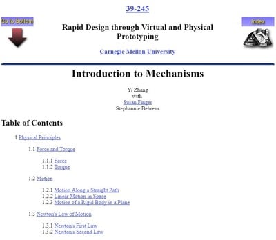

I found this on Google. Provides designs and equations.

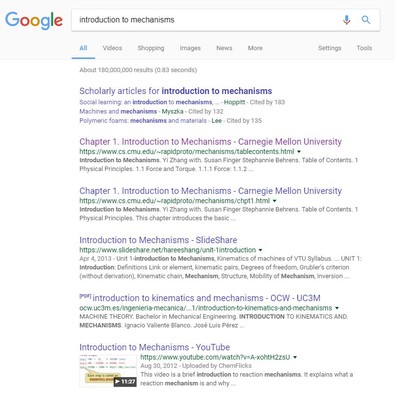

Re: Flat Faced Cam Design
08/09/2017 11:16 AM
Seriously? Can you not do it yourself?
It is very easy to type "Introduction to Mechanisms" in Google, which gets you this:
Choosing the second item in the list takes you there:
Took me about 10 seconds to do the search!
08/09/2017 8:36 PM
As a link, why ? ( Using the word, " why " , is it necessary to then use a question mark, ? . )
Do you have access to the Google search engine ? If you indicate the internet provider that you use and it's limitations, there are many folks here that would love an opportunity to help advise you.
I simply opened google and typed in the search box ( Lyndoor industries showed me how to do it ),
flat faced cam
