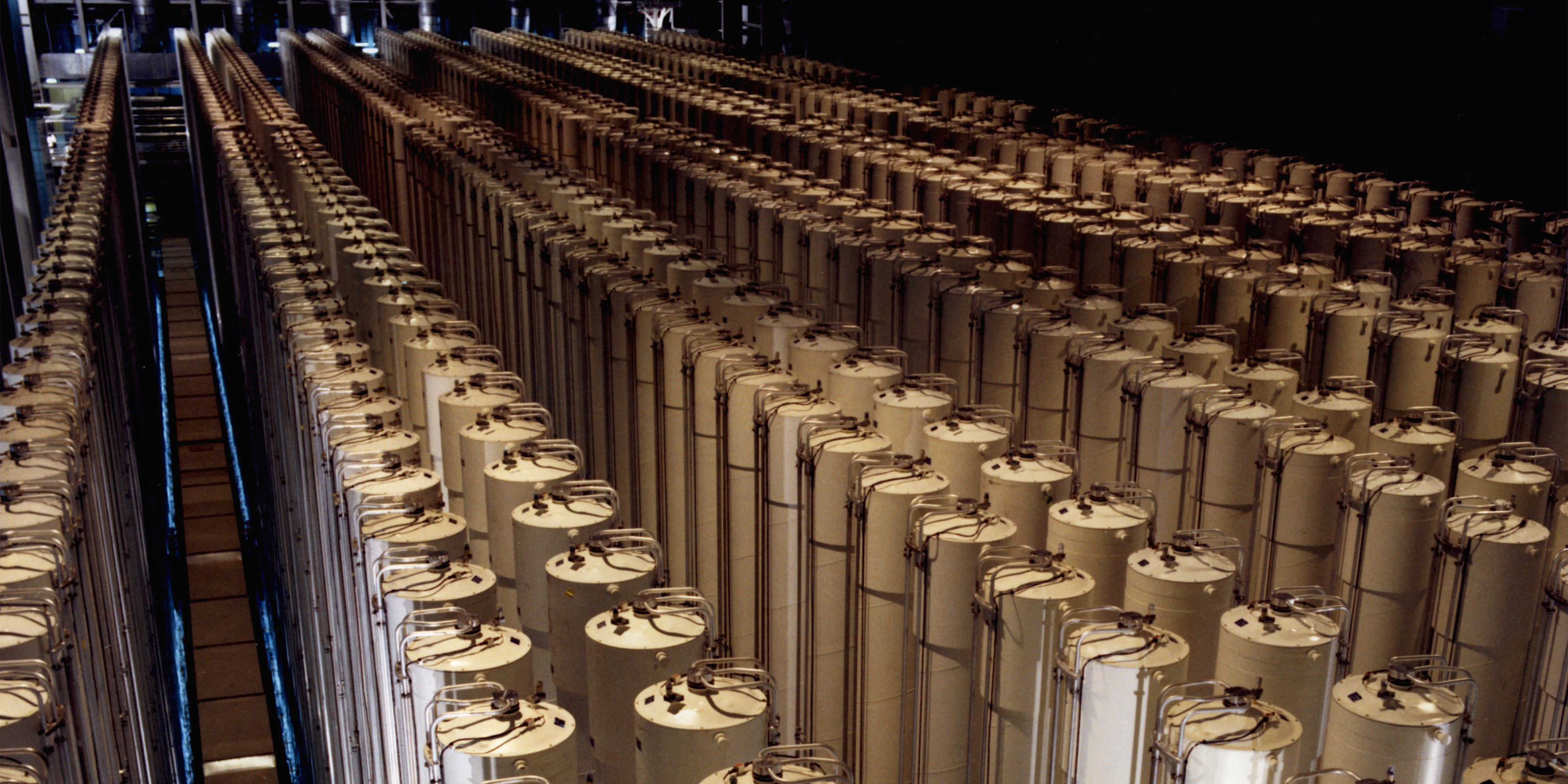

These tall skinny centrifuges are used in nuclear fuel enrichment, they are operated in both series and banks of parallel in a continuous process...50k rpm
https://en.wikipedia.org/wiki/Gas_centrifuge

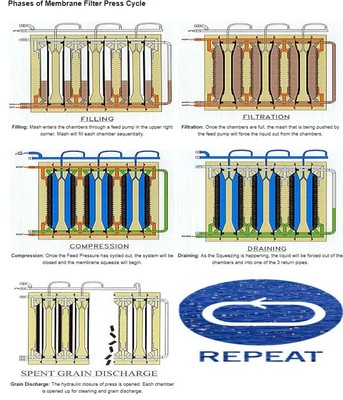

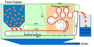

I may have missed the reasoning, but have you considered filter presses. Is the product pressure sensitive?
Belt Filter Press (continuous)
Membrane Filter Press (Batching)
Re: High Speed Machinery
08/10/2017 8:05 AM
