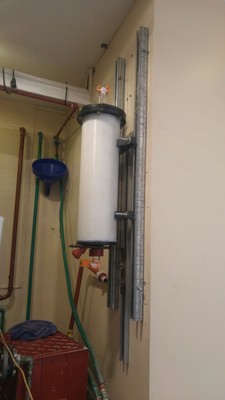

Hi, a time ago one of our laborers misadjusted the lid of a large borosilicate shell - coil type cooler and broke it.
The shell of the cooler measures about 1000 millimeter in length (40´´) x 300 millimeter (15´´) diameter. Glass is about 30 mm (1 ¼¨) thick.
The cracked area is the entire circumference of one end of the cooler (looks as if it had been beheaded).
First idea was to replace the cooler, but 15,000 U$ a piece were an argument important enough to search for a “B” Plan first.
Second alternative was to hire some “expert” to repair it. Some guys came and after a couple of Hmm´s and Oh´s did not show up again.
The coil (where the fluid to be cooled passes trough) is intact. The coolant (water) circulates between the spirals of the coil and the inner wall of the shell at a pressure that can be regulated, but lesser than 14 PSI (1 Kg/cm2)
My idea is to have it thoroughly cleaned and degreased, to glue all the small chips together using some aneroid adhesive like those used to attach mirrors to windshields, and finally to perform a bandage using some epoxy composite like a woven material (fiberglass, Kevlar or carbon fiber) soaked in resin.
Any other ideas?

The cooler is installed at a port of a glass lined reactor that operates at 100ºC at atmospheric pressure. Corrosive fumes / vapors are very effectively condensed in this glass cooler so they drip back into the reactor.
It cannot be air cooled because it is very corrosive to most materials except glass.
There are no other ways to cool it down.

Good luck gluing it together. My experience with broken glass is that there are always tiny shards missing when I try to reassemble. You might want to investigate any reactions between Acrylic Acid and the glue you are planning to use.
Posts: 1679
Re: Glass Cooler Repair
09/12/2017 9:03 AM
There will be only water in contact with the glue.
I called Henkel. They suggested me to use an adhesive based on modified silane.

09/12/2017 9:39 AM
Any epoxy which is recommended for glass will glue and fill any gaps if there are bits missing.
Sounds as though the broken part is not critical so any reasonable fix should work OK.
Posts: 1679
09/12/2017 10:58 AM
I have been doing some research during the last days and (against my previous knowledge) Epoxys seem to have more cons than pro´s in the repair of glass.
Henkel recommended the use of modified silanes for gluing the bits together and also wrapping it in a bandage wit silicone for reinforcing the tube

Call the folks at Norland. Their business is making hard curing adhesives for bonding glass together.
Dentists use UV curing cements for lots of dental work, and those cements last for years under a variety of stresses (biting can create a surprisingly large pressure in terms of pounds per square inch) and with a lot of moisture around.
A lot of UV curable adhesives are used in military programs that have to withstand a tremendous variety of environmental conditions.
http://www.norlandprod.com/UVdefault.html
09/12/2017 10:11 AM
Calling Henkel was a right first step. Asking them,or Norland, is always better than asking the forum, because we all think the goop we used to repair our broken widget is the best.
There's probably no way to etch, or roughen the glass surface with acid, but even sanding with 180-220 grit paper would help with adhesion. Kevlar may be overkill and is difficult to cut besides.
Again, the advice of an adhesives manufacturer is always best.

Is this the shape?
A glass worker can remelt the glass together...
http://www.adamschittenden.com/Repairs.php
Posts: 1679
09/12/2017 12:17 PM
Yes, it is more or less the shape, the difference is that ours is massive: it weights about 30 kilos (60 pounds) and is (at least 3 times longer than the condenser in the picture)
I called a company specialized in glass repairs, but they said borosilicate glass (Pyrex type) cannot be repaired.

I know for a fact that Loctite 349 (UV curable) will work on borosilicate glass. I used it to repair my 3D printer plate several years ago.
Whether it will stand up to the chemicals?
Good Luck!
Posts: 1679
09/12/2017 1:57 PM
Well, that is exactly the adhesive Henkel did recommend. The adhesive will never be in contact with the chemicals, as the shell (containing water) is the broken part.

The other day I saw the repaired glass condenser and remembered my post here in Cr4, so I want to share the image of the way the condenser looks today:
The broken glass shell was removed and replaced by a new one made in plastic.
It is still being tested. so far it works great. ONce ready for operation definitive connections will be made in glass
