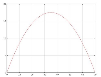

I made some plots to illustrate how I interpret the problem. The ball is thrown 'a' units from the pole (and not necessarily at ground level) at a 45-degree angle (slope = 1), passes horizontally just above the pole, and falls to the ground distance b from the pole. Given a and b, find the height, h. of the pole.
x = linear distance, y = height of ball,
equation of curve: y = h - Ax2,
slope of curve: y' = -2Ax
at x=-a, y'=1, solve A=1/(2a)
at x = b, y = 0, solve h = Ax2 = Ab2 = b2/2a
This doesn't fit any of your four choices, although if a=b, (the ball is thrown from ground level) option 2 would be correct.

OK, let's go with your assumptions:
Ball is thrown from elevation 0
Ball passes top of pole distance a, not necessarily at apex
Ball lands distance b past pole
Let's put launch point at origin, pole at x=a, and landing at x=a+b
Equation of trajectory: y = Ax2 + Bx + C
Slope of trajectory: y' = 2Ax + B
At launch point: y(0)=0 -> C = 0
At launch point: y'(0)=1 -> B = 1
At landing point: A*(a+b)2 + (a+b) = 0
divide by (a+b) , solve for A: A = -1/(a+b)
Solve for y at pole (x=a)
y(a) = (-1/(a+b))*a2 +(1)(a) = -a2/(a+b) + (a2 + ab)/(a+b) = ab/(a+b)
Launch point 0
Pole at a = 20
b = 50: Lands at a+b = 70
height of pole h = (ab)/(a+b) = 1000/70 = 14.286
I think this is what the author of the problem intended.
