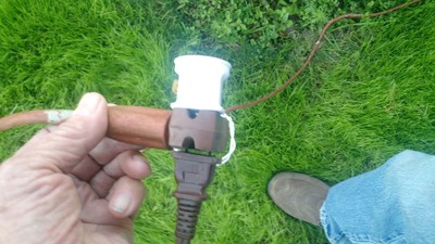

Here is yet another photo of the plug that is the cause of my grief.
I believe that it is clearly an ungrounded, unpolarized, hermaphrodite/gang/multiple plug item.
There is only one of these ungrounded, unpolarized, hermaphrodite/gang/multiple
plugs per string of lights so that an extension cord is required to connect multiple
strings for the desired effect, shown here.
Merry Christmas to all, and to all a good night.
Re: Polarized Extension Cord Feeding Non-Polarized LED Supply Cord
11/29/2017 6:37 PM
Slowly, we're getting somewhere...
From your post #20, I had the impression that the multi-outlet adapter
was the problem.
Now it appears that that adapter was not the problem, and totally unnecessary as well. If you had plugged the white hermaphrodite connector directly into the orange standard 3-wire extension cord, then you could have plugged your (modified) 2-wire extension cord directly into the female side of that white connector.
Now, to answer your (I think original) question: "...why not make one slot of of the female, non-polarized socket wider to accommodate a polarized plug?".
Doing so would give the impression that that female connector is polarized, when in fact it is NOT.
If you were to widen one of the slots on the female side of the white connector (or on any other non-polarized device having a female outlet) then a polarized device could be plugged in to that outlet. In your particular case there is no need for polarization, since (I presume) all the devices powered by that second extension cord are non-polarized devices.
But think for a moment about a standard metal-cased toaster having a two-wire polarized cord (mine fits that description). Toasters include heating elements which are directly connected to both sides of the power line during the toasting process. These heating elements can and do fail, at which point the broken ends of the heating element flop around, potentially touching something connected to the case. In some such toasters, the case is connected to the neutral, so that should a point near the hot end of the broken element touch, directly or indirectly, the case of the toaster, it would blow the circuit breaker and turn off power. If that plug had been modified like your extension cord, there would be a 50/50 chance that the case would be connected to the hot side of the power line, putting anyone touching that case in serious danger.
Similarly, people commonly stick forks and knives into toasters to recover stuck pieces of bread etc. The switch that connects power to the heating element to turn on the heat MUST connect the previously disconnected end of the heating element to the hot side of the power line, so that when not toasting, all of that element will be at neutral voltage. Then a knife or fork touching the heating element will cause no harm. (Anyone sticking a fork or knife in there while it is toasting is on Darwin's list)
Finally. let me remind you that experienced folks like you and me forget things... LABEL that modified extension cord as NON-polarized, so six months from now you won't use it to power some other device that requires polarization for safety.
