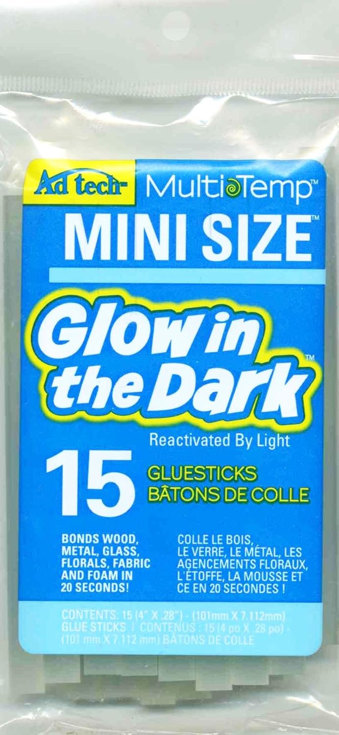

High Visibility Marking with Pigmented Hot Glue
For low resolution but high visibility you could try hot glue in colors. I have seen the assorted color pack in hardware stores, hobby stores, and even Walmart. If you have a lot of this to do you might want a workstation setup with each color in a different gun. You could then color code something(maybe oil weight) as well as having written info(maybe purchase date) or whatever you want. I only had a clear glue stick with a slight yellow cast to it but I was not unhappy with the result you see in the picture except for the resolution and the stray strings. The adherence seems pretty good but I have not tested oil resistance. The picture of the bottom of the bottle is so you can see the test was on an HDPE type 2 bottle(Kefir empty).
I used a corded gun but they make cordless ones if you prefer. If you do not need color coding you could get high visibility cheaply with just black glue sticks. The stray glue strings you get when you lift the gun might be annoying. You might test it on a bottle with some oil already on the outside to see if it works on those before you actually decide. Sanding might help adherence but I suspect that it holds well enough without it on a clean bottle. They make hot glue guns with finer tips and you have a choice of two popular stick sizes in most stores.
You should be careful not to violate bottle integrity since hot glue and bottle plastics melt at similar temperatures.

Re: Writing On Polyethylene Bottles
12/06/2017 11:01 AM
My only question to this technique, how well really does it adhere in the long run?
12/06/2017 1:00 PM
How about as long as the bottle does.
We used hot melt sticks to "stick" PE together years ago and it works.
Glue Stick Review | Plastics Hot Melt Sticks – Hotmelt.com
"This hot melt is perfect for bonding PP, PE, PET, and PCV and also bonds porous materials."
12/06/2017 2:00 PM
True that, but when I picked this mini-gun up the other day at Harbor Freight, I was in the "grab-and-go" aisle. You pays your money, and you takes your chances..

Don't quote me on this, but there MAY be things in the hot melt that "after prolonged, repeated exposure to the lips and gums" may be irritating. Toxicology was not my field.
I'd pull up the MSDS/SDS for the specific brand of glue stick you have and see what it says about hazards.

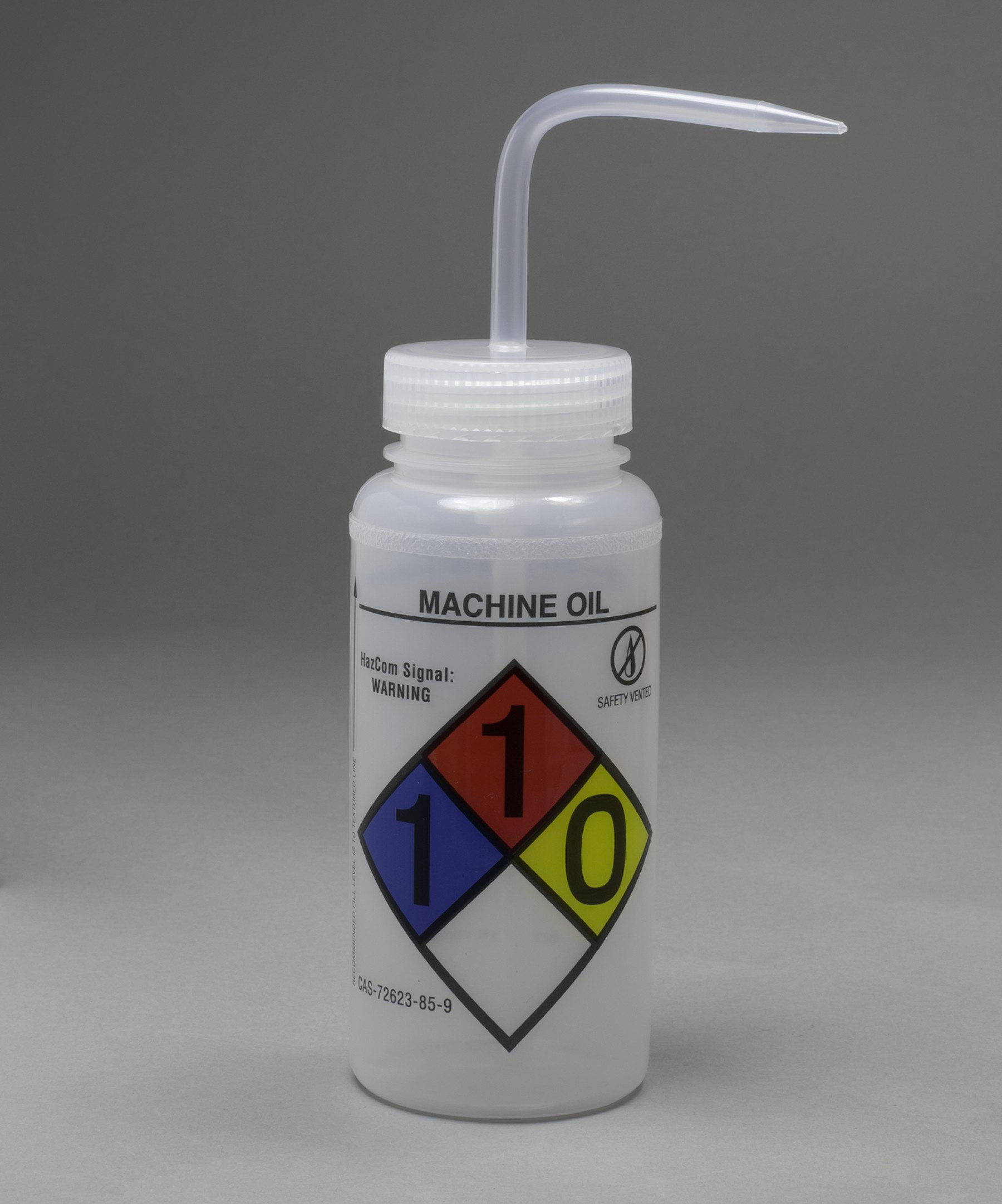

Depending on your project (mainly the amount of bottles you want to write on) you may use a suitable heat shrink tube you may buy blank (and write on it) or even have it printed:
12/06/2017 1:59 PM
Bel-Art has these and more.
Here is another supplier of HDPE labels to apply to containers:
https://www.label-aid.com/polyethylene.html?_vsrefdom=ppcgoogle&utm_source=google&utm_medium=cpc&utm_term=hdpe%20labels&utm_campaign=labels&gclid=EAIaIQobChMIg_aGi4j21wIVBmx-Ch1m3QD3EAMYASAAEgKCYPD_BwE
not meant as advertisement or endorsement, but looks promising.
