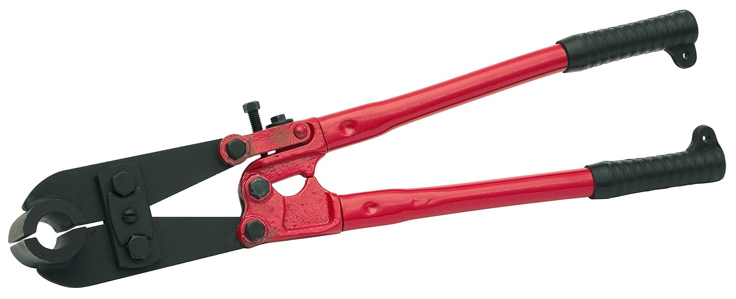

How to Remove Deformation in End of Aluminium Pipe?
01/19/2018 7:14 AM
Anyone have an idea of a tool or device I could buy on eBay or somewhere that would enable me to remove the deformation in a number of pipes like the one in photos. I have 40 such pipes and the deformations are all at the ends like in photos. I was thinking maybe some circular metal insert that would expend as a screw was tightened ... or something. Thanks for your time.

Google "tube expander".
Something like this (not an endorsement)?

A tool called a swedge will do what you want. Unfortunately, swedges are designed to expand pipe to a larger size. If you were to try to use one on your aluminum tubes, it might expand it more than is acceptable for you.
My suggestion would be to find or make a tapered shaft/rod that you can push into the open end. You might still risk enlarging the end, so you'd have to decide if that's OK.

Well, a tool called a rerounder is available, but I sort of doubt it will work here.
Shown is a Reed RCR1 - not an endorsement
Your image appears to be alum pipe sized the same as steel pipe - can you confirm?
Boiler tube expander might also work. Probably ruin the tool within a small number of uses, if you can acquire the appropriate size for your need.

Go to a machine shop with those tubes, and have them chuck up in lathe on a straight portion (assuming the tubes are not generally bent), then use a standard Morse taper, to round out the end I.D.
I doubt even that will restore all the damage to the roundness on the ends.
How round do they need to be, and what extension along the length is required?
A Morse taper will only work on the very distal end of the piece.

Most of the suggestions so far involve techniques that will work but will also stretch the aluminium creating a larger diameter. I have never seen the type of tool that I am proposing but it should be easy to make. I suggest that you roll out the deformation. with the equivalent of a roll bender. Get a piece of metal that you can fix upright in a vice 100mm of 50mm x 6/8/10mm strip would be ideal. Drill and tap two M8 holes both about half way up, equidistant about the vertical center line and 16mm apart (enough clearance to turn hex bolt heads). Cut an 8mm x 15mm vertical slot on the center line with the bottom of the slot 10mm above the horizontal center of the tapped holes. Screw all the way in 2x 30mm x M8 bolts into the tapped holes so tha 20mm of thread is protruding from on side. Slide a 20mm length of 8/10mm bore steel tube over each bolt to create rollers. Fix an M8 x 30 bolt into the slot with an M8 nut and tighten to a slide fit. Slide a 15mm length of steel tube over the top bolt to create an adjustable third roller. Place the workpiece onto the top roller with the flat uppermost. Slide down until the work piece is nipped between the top roller on the inside and the other two rollers on the outside. Tighten the nut. Rotating the work piece by 360 degrees will roll out the flat without stretching the metal. Once set all the other work pieces can be corrected with out any resetting. Make sure that the outside of the roller tube is smooth as the aluminium will imprint any imperfections. The sizes suggested reflect what I keep in my workshop, imperial equivalents, shorter or longer bolts, whatever you have to hand would work just as well.

I have had luck just tapping in a tapered drift punch.
You will stretch the pipe / tube to a larger diameter. You would need to try and see what you tolerances are. Any reworking will change dimensions because you have to take the material to the plastic state and that will cause a dimensional change. Reducing the diameter after the bend removal may be accomplished by drawing the pipe through a round die. ( A piece of metal with a hole of the correct diameter and a chamfer to allow easier drawing).

If the pipe end is too hard to correct the shape with a good pair of pliers (not a 'screwdriver' ha ha!), then you need to anneal it regardless of what other tool is used to restore the round shape. Otherwise it's liable to crack during or after your repairs.
I haven't worked with aluminum myself but the anneal process is to heat to 650-775 F (depending on the alloy) and allow it to cool slowly without quenching. This softens it so it can be worked without cracking it. There are some simple tricks for gauging the temperature - lampblack (soot), or soot from a candle flame, or marks from a Sharpie, will burn off at around the right temperature so you don't overheat the metal. The problem with aluminum, the anneal temperature is close to the melt temperature, so it's key not to overheat. You don't need a full anneal to repair the tube end, just soften it enough. The work you do to repair the shape will harden it. If you use pliers to get the opening right for your tool, do it gently and not more than necessary. Get the mandrel, swage or re-rounding tool in, and use a mallet to shape and work harden from the outside.
Also think about your application, and how important is the integrity of those pipe ends. Preformed and hardened material has integrity which you can't be 100% certain to restore by repairing the damaged shape.
