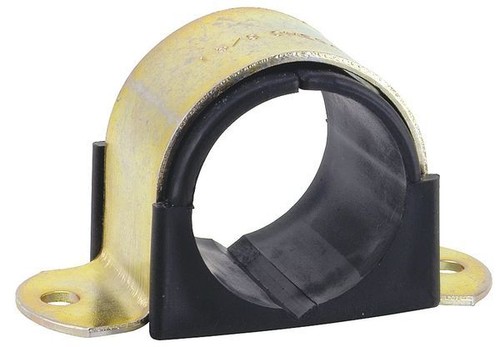

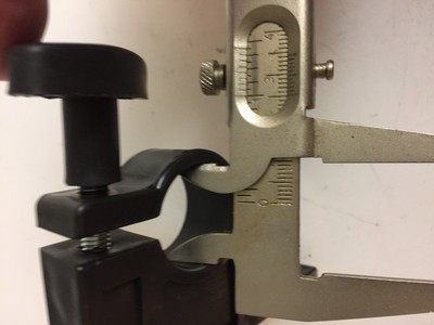

I recently purchased this tilting adjustable height couch table....but there are a few problems with it...first, the top is supposed to attach to the crossbar with 2 clamps...
The clamps are 25mm and the bar is 32.5mm...
I have got a partial refund and ordered some new clamps...
4 ea 1 1/4" ....but the holes don't match and I ordered 4 just in case... so the question is, this tabletop is probably pressed board with melamine type coating and the original holes have inserts....What would you use to attach the top to the bar, bearing in mind that the angle of incline for the top must be adjustable...
The top is 15mm thick...

https://www.woodcraft.com/products/threaded-insert-brass-6-32-8-piece?utm_source=bing&utm_medium=cpc&utm_campaign=PLA&utm_term=159287&utm_content=All%20Products
I have used these before (or something very close) in repairing pressboard furniture, they work well.
Looks a lot better then the drill all the way through, bolt, nut, and fender washer method.

This is a slightly different style, intended to drive flush and stop at the surface.
Going to need care to not drill thru the top... might have to select the closest size and grind off a little bit.
A search for furniture assembly parts, furniture fasteners... maybe check the Ikea parts books?

I used an adjustable drill stop to make sure I didn't drill all the way through. I also put a dab of wood glue in with each one.

I'd go with one of the threaded inserts, after applying a healthy dose of epoxy to the holes. For insurance against filling the ID of the insert with epoxy put some lubricant on the matching screws and screw them into the insert and leave them till the epoxy cures.

Tricky...
There are plenty of screws designed for that material but you don't have much depth to play with.
I'd be tempted to drill a pilot hole, screw in a suitable screw, but without tightening it too much. Then remove the screw and drip in a good quantity of low viscosity cyanoacrylate glue (superglue) to stabilize and bind the particle board..
Alternatively, maybe use epoxy to glue in studs and then use nuts and washers to tighten down the fittings.
A further alternative, Glue a sheet of good quality 1/2" ply to the underside to give you more depth to screw into... this may actually be the best and simplest option.
Best to try out on some similar scrap material first if possible.
Good luck
PS, if this doesn't get a GA... I send the boys round

He could use the original holes, add some aluminum strap pieces about 3 mm thickness, by 3 cm width, and have countersunk screws on the sides of the straps facing the table top underside.
That makes customization possible without drilling into the top at all.
or use inserts.

Maybe the safest way is to make a couple of adaptor plates out of say 10mm x25mm Aluminium/aluminum bar that you can then fix to the table top using the existing mounting points. You could likely still use one hole for both the plate and the new saddle, with the other screw countersunk under the saddle and a threaded hole further out on the plate to take the longer saddle.

The way I would do it would be to use a 5/8" dia forstner bit ( a bit that leaves a flat bottom hole) and drill to a depth, about 7/16" deep. I would then cut off some 5/8" wood dowels and glue them into the holes. Space them to match the center to center hole distance of the new clamps. After the glue has set, locate the holes over the dowels and use sheet metal screws to attach the clamps to the dowels being careful not to use a screw that is too long. The board is probably MDF or particle board, so threaded inserts may not grip well.

I'm more impressed by the fact you know how to read a vernier caliper! I've got people here at work that can't read a digital caliper...

Clamps have arrived....perfect fit
Still waiting for inserts...
