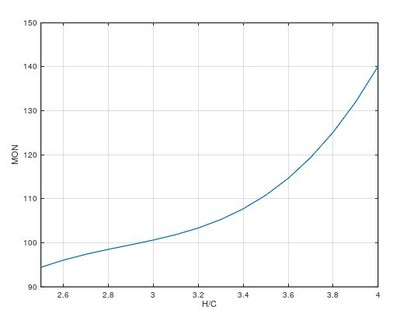

HI,
406.14 + 508.04*(H/C)-173.55*(H/C)^2+20.17*(H/C)^3
can any one tell me what is in above formula 406.14, and 508.04 , and 173.55 and 20.17
please need guide line to further learning .

06/12/2018 9:34 AM
MON = "Motor Octane Number"
(H/C) is hydrogen to carbon ratio
It's a formula for determining the equivalent octane of natural gas.
I'm pretty sure the numbers were determined by curve fitting to actual data.

Re: MON/Methane Number
06/12/2018 11:02 AM
For what it's worth, here's a log-log plot of F(x) vs x, where x is H/C, and F(x) is the given formula.
A log-log plot seemed like the most useful graph; linear-linear and log-linear had funky axes for the info.
06/12/2018 8:28 PM
If the x-axis is H/C ratio and the y-axis is Octane rating, only the lower left corner of the graph is realistic. H/C for methane is 4 and it goes downhill from there. The formula is only valid for H/C = 2.5 to 4.
The OP has a sign error. MON should be
MON = -406.14 + 508.04*(H/C) – 173.55*(H/C)2 + 20.17*(H/C)3
Here is a plot:
https://www.scribd.com/document/241241715/Carbon-Hydrogen-Ratio-of-Natural-Gas
