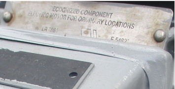

Dear All,
I observed Reliance Electric Motor TEFC certification CSA LR7861 (photo as attached) installed in our oil and gas facility. There is nameplate indicate "Recognized Component Electric Motor For Ordinary Locations". No other information in the motor enclosure and could not find the datasheet of it. Is it suitable for use in Hazardous Location especially in class 1 div 2 area?
Thank you for any comment.

No.

Class 1 Div2 implies you could have an explosive atmosphere under fault conditions - like a leak in what looks like a driven compressor in yr photo & inadequate ventilation to disperse it. THIS IS NOT AN "ORDINARY LOCATION".
It is just possible the motor & coupling housing are pressurised with "gas-free" air & an approved pressure monitor/shutdown system.
But, according to memory, "non-sparking" includes not having hazards like a light alloy fan and a steel shroud around it - which can spark by mechanical contact.

As already mentioned, NO!
The appropriate motor must be used and the one you have DOES NOT COMPLY!
By trying to save a penny you could KILL PEOPLE, as in make them PERMANENTLY DEAD!

It might be allowed by code, and might be ok'd by the AHJ...but it's not a good idea....

That type of motor is a “UL Recognized Component”, not a “UL Listed” motor. The difference is that the motor can only be used as PART OF a listed ASSEMBLY. In that light, you cannot single out that component as a stand-alone device, meaning NO motor that is only “UR” will be “listed” for anything all by itself. If the ENTIRE COMPRESSOR is UL listed for Cl 1 Div 2, the info on thenameplate is irrelevant. So presumably the compressor mfr would have had to engineer and assemble it into the compressor package in a way that meets the requirements for UL listing in the classified area.

I also found motor with the same mark "Recognized Component Electric Motor For Ordinary Locations", but in the motor enclosure also have nameplate indicate the motor suitable to be used in class 1 div 2 GR CD T3. in the nameplate indicate reliance electric 841XL. What is the type of protection for this motor? is it Ex-na?

I suspect protection type is Ex(p), IEC code - that is pressurised, it might be N - non-sparking, but I have seen that only when motor is outdoor, outside hazard area driving purge duct fan & yr first photo seems to drive adjacent compressor. Is the "green snake" in photo a pipe or cable?
It is a practical way of converting a standard TEFC motor to Ex. The complication is in having pressurised clean air - no problem in a plant using lots of pneumatics - and a certified fail-safe scavenge air pressure & flow monitor which stops the motor for any air fault. Also motor has to have bearing seals which do not mind Δp - not a problem to a maker who has experience with hose proof/ship deck/flooded motors. And some requirements like not having a magnesium alloy casing which sparks if you drop a steel hammer onto it or a fan housing which could contact the fan.
As has been commented, motor would be part of a UL or equivalent certified assembly with nominated critical components and approved drawings - Reliance probably safeguarded themselves by labelling motor "ordinary locations" to avoid users thinking "magic is in motor".

the "green snake" is grounding cable from structure to motor enclosure.
In other plan that use IEC std, we have ABB motor and its clearly mentioned the Ex protection is Ex-de.
but for the facility that using ANSI std it's not clearly mentioned the Ex protection, only statement classified for Class 1 Div 2 area.

Ex-de would be combination of d -flameproof (which is an enclosure with such narrow gaps & wide flanges that no flame will exit if you ignite flammable gas inside enclosure) and e - increased safety, which has such low temperature rise, insulation thickness & clearances it will never spark - probably the terminal box in this case. Ex(e) was much a German technique e.g. flameproof Ex(d) switch in Ex(e) panel: but in some cases, low ignition temperature risk, it is most economic.
