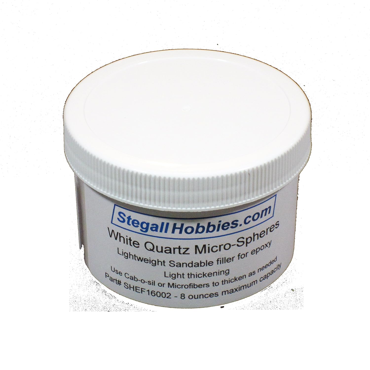

The glass micropheres are very effective and their longevity is.....well glass. The "coating" over this metal roof is the weak link. and The metal would have to be "prepared" beforehand. The sun, rain, hail, plus the make up of the "glue" will in short time, put it on the ground. Also these polymers have a curing time, and the time and labor and expense, make this (in my mind) better spent, making sure this lightweight metal porch roof is strapped down and secure. The sun won't hurt you but the wind will.
