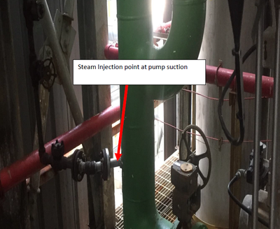

Currently there is an operation scenario at one of our plant which directly injecting steam into cooling water line at pump suction in order to generate hot water at 60 deg C for circulation, by doing this its generate vapor at pump suction and lead to cavitation which ultimately damage pump and mechanical seals. Please advise better solution to this rather than installing a heat exchanger.

Inject it far downstream of the pump outlet. Pay the money for a heat exchanger.

Inject the steam into the pump discharge, perhaps. The present scheme is totally f insane.

There are fewer worse ideas or better ways to induce cavitation and damage a pump than to inject steam into the suction side.
Be mindful of the fact that steam injection into cooler water causes much turbulence, vibration and other conditions that will MECHANICALLY DAMAGE THE PUMP, IMPELLER AND PUMP SEALS !!
Reconfigure the piping system and inject the steam into the discharge side of the pump.
Purchase a device designed for this purpose and take the advice of the vendor for preffered piping configurations.

Thank you for the feedback. Its a cooling water pump not vaccum pump. During normal operation it will circulate using cooling water for Reactor, however during no reaction they need to circulate with hot water at 60 deg C so that the fatty alcohol inside the reactor will not solidify. So in order to get hot water at 60 deg C for circulation they directly injection steam at pump suction which they throttle steam via manual valve. This is the current scenario. Please find attached Photo for reference. There is another latest update, i have find out there is condensate tank nearby which most of condensate being send to drain. If i replace the steam injection with this condensate from condensate tank at pump suction to get hot water at 60 deg c, is that it will solve the problem since there will be no steam bubble? Thank you

You could still end up with cavitation depending on the pressure in the pump suction and the temperature of the condensate. The temp of the condensate will likely be similar to the steam, however you won’t have the heat release of condensing the steam. If easy to do, give it a try, without checking the calculations. You will need a heck of a lot more condensate to get the temperature you want, so that might help pressurize the pump suction.

Thank you for the feedback. The pump suction pressure is 1 barg and and steam injection pressure is 3 barg, hence steam pressure is definitely higher than pump suction pressure.

That suction pressure will help cavitation if you are pumping condensate instead of steam. Your end temp is 60C, so if you control temp into/through pump at 60C, it’s likely it will eliminate your cavitation damage. You just need to make sure you can pump enough condensate to raise the temperature of the water to your 60C target.
