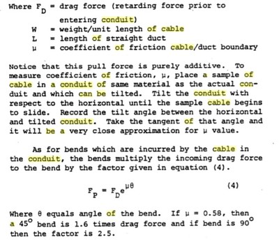

Our Project has currently selected 6 inch PVC-U conduit (internal dia 150mm) which has 12 sub-conduits (1inch each, external dia 31mm) at 90 degree angle entry into the building and a bending radius of 914mm.
The FOC we have selected (24 core and 48 core) with Maximum pulling force / Tensile strength = 2700 Newton, Cable outside diameter, nominal = 16.50mm and Cable weight, approx = 302kg/km, Minimum bending radius: - Under maximum tension = 20 x Cable O.D.
I would like to calculate if this FOC shall be safe to pull within the subduct at 90 degrees as mentioned. I have been trying to get online calculation software for FOC but to no avail.

A simple telephone call to the <...FOC...> supplier will answer many questions, because some things do not respond to calculation; the "slipperiness" or state of lubrication of the <...FOC...> and the inside of the <...6 inch PVC-U conduit (internal dia 150mm) which has 12 sub-conduits (1inch each, external dia 31mm) at 90 degree angle entry into the building and a bending radius of 914mm...> being singular to this particular installation.

Not my expertise, but there will be another force to consider and that will be the sequential deformation of the cable as it passes through the bend area. This will highly dependant on the individual cable configuration.
Imagine the effort required if the cable was a single solid core.
As others have suggested, contact the cable manufacturer for their support.

<...Tensile strength = 2700 Newton...> ≅ 1/4 tonne.
So it would take a pulling machine to break it. A human is usually not capable of providing this force without some mechanical contraption.
The firm installing the <...FOC...> would be able to advise.

Do not use WD-40, baby oil, grease, vasoline,etc, as these materials can deteriorate the insulation over time. ...use proper wire lube....

Talc will do a great job of lubricating the cables.
Beware the twang factor, if the cables go twang you have overdone the pulling.
To get technical you could use a Force Gauge connected to your pulling device to ensure you do not exceed the maximum allowable value.

Just a thought: it would probably be a lot easier to pull the fibre straight into the sub-conduits, then, pull the sub-conduits into the main conduit.
