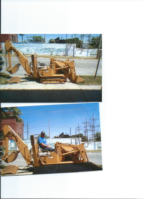

How about one of these? I bought this when I was in the construction business. served Me well.
